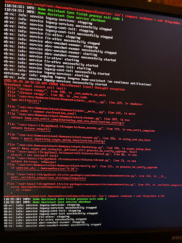

Thanks for your feedback. I have tried the “ha core logs –follow” command and got some text. I attached the screenshot pic in this message.
hmmm that doesn’t look good , as i thought somethings wrong with the installation process, it seems
