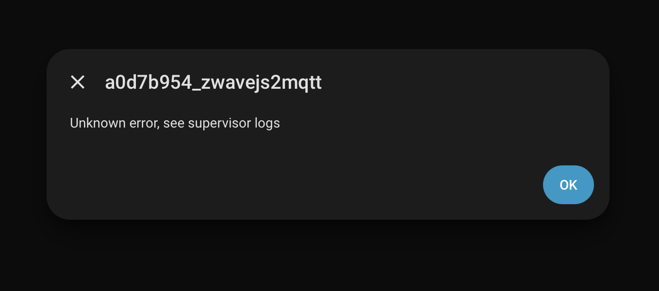

Can't connect to zwave-js ui
When I try to open zwave-js ui I get this message-
The log seems to be repeating the same message constantly-

Have you tried restarting the Z-Wave JS app? Could it be that the Z-Wave JS app installed itself?
If that doesn’t work, try unplugging your dongle for about ten seconds and then plugging it back in. Then restart the Z-Wave JS UI app.
It sounds like you’re stuck in an infinite restart loop. Has your server been running before, or is this the first time you’re starting it ?
I finally managed to isolate the problem in the logs after rebooting the system hardware. Looks like the system isn’t finding my ZWA-2 antenna, I think???
[09:23:45] INFO: Starting NGinx...
2026-08-26 09:23:54.657 INFO Z-WAVE: Controller status: Driver: Failed to open the serial port: Error: No such file or directory, cannot open /dev/serial/by-id/usb-Nabu_Casa_ZWA-2_80B54EE77994-if00 (ZW0100)
Got it fixed. Just needed someone to unplug/replug the ZWA-2 since I’m not at home.
