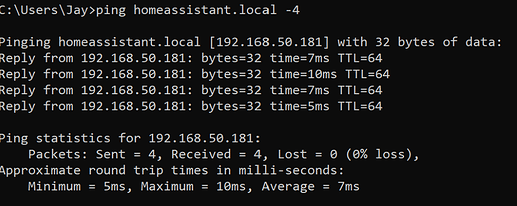

If possible, from a PC, open CMD and enter ping homeassistant.local -4. If it shows a reply with the following, it’s running and may point to some other issue.

It pings fine and the router shows that it’s there. I’ve tried it with two different USB to ethernet plugs and one wireless USB plug. It’s kind of an oddball setup but I’m just trying to see how well it works and how it configures and everything the computer is a chuwy Windows tablet but it only has USB a and c no ethernet ports so I have to use an adapter. That should work though because it shows up on the network, Asus bt-10 and it pings. If it works well I don’t know if I’ll keep this as part of a setup or just buy a box but I wanted to see what it would do to replace all the other hubs that I’ve got that are all going to paid.

Ping 1 ms. Ttl 64

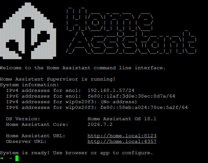

Do you see this screen on the terminal on the Home Assistant server? Is the IPv4 address on this screen 192.168.50.194?

Yes, exactly
