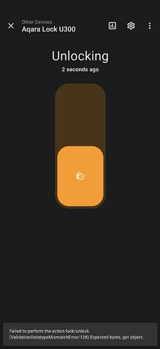

Can't control lock anymore. I keep getting a long error message that I don't understand
So I discovered this morning that I was unable to control my Aqara U300 lock. I didn’t make any changes or update anything. When controlling it in the Aqara app, the state of the lock still changes in HA. Since I have no idea what to do, I just removed it from HA and the Aqara app(also over Matter) and added it back to only HA over Matter. But nothing changed and I’m still getting the same message.
I have no idea what that means. I googled it but that didn’t help at all. Does anybody know what I can do to fix this problem?

The “got object” message usually indicate a discrepancy between what HA expect of value type and what it actually received.
Typical causes can be that the device is unavailable, renamed, updated, so it represent itself differently or otherwise changed.
Check the device in the settings - device - integration menu in HA.

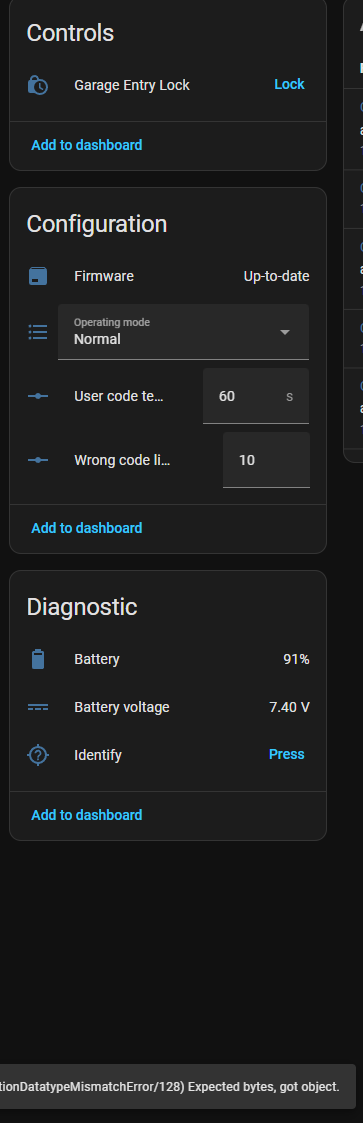

At the page I referred to can you there control it by clicking the controls?
If you mean from the device page in the Matter integration from Devices and Services section, then no I can’t control it from there. I’m getting the same message I do when opening up the lock control entity.
Might as well upload a pic just in case.
