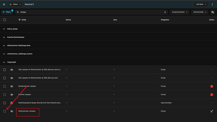

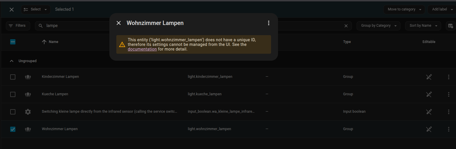

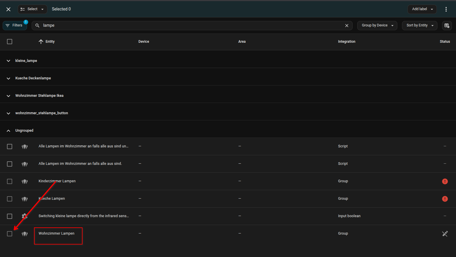

I have an older entity, called light.wohnzimmer_lampen that I can neither change nor delete.
I tried it from the “Helpers” tab, but there simply wasn’t an option to delete
I tried it fromrom the “Entities” tab, but I couldn’t even mark the checkbox next to it.
I checked my groups.yaml, but it’s not in there.
Can anybody help me delete this thing? Or make it so that I can edit it again?

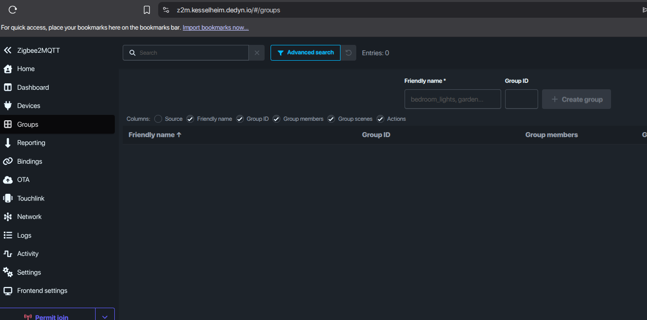

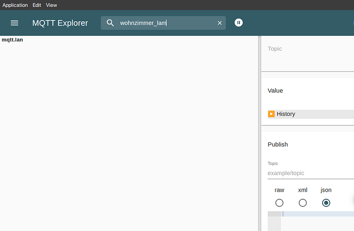

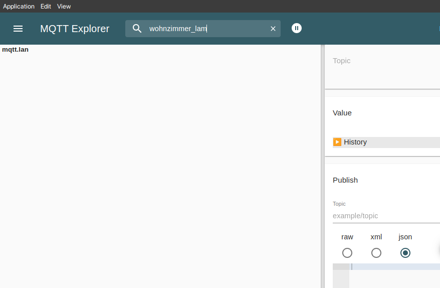

Great idea! Unfortunately it isn’t:
I checked the mqtt server and it isn’t some retained message either
