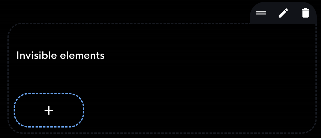

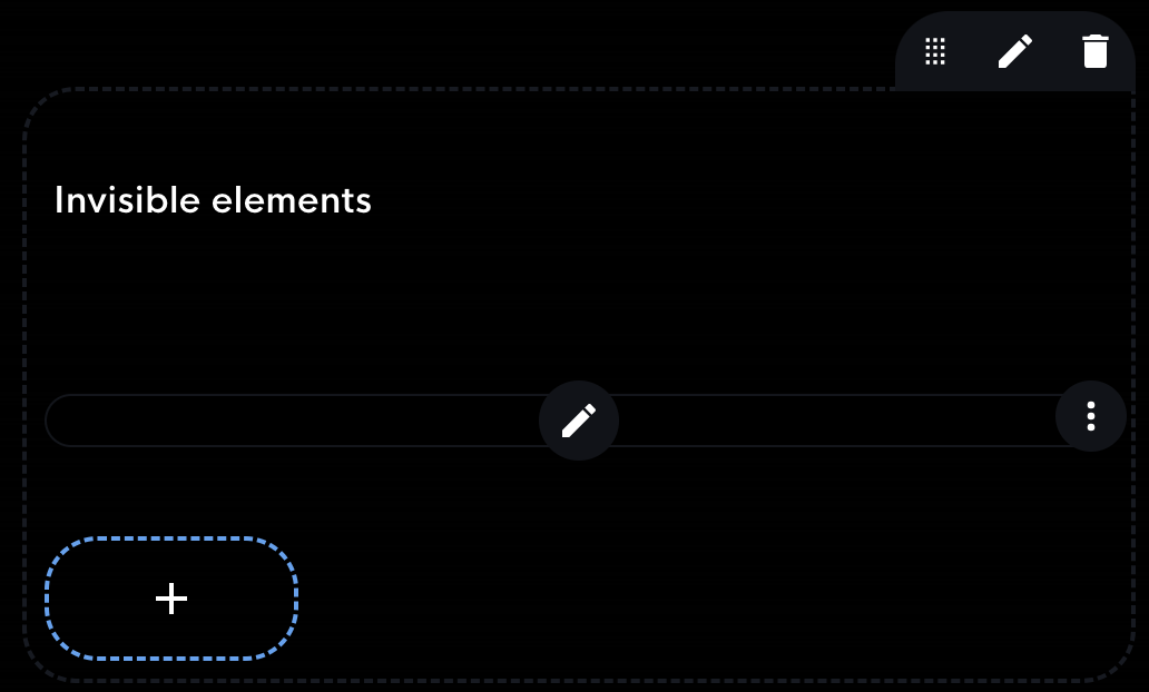

So in older versions (HA 2025.8) you could still hover the empty cards to edit the yaml:
But now in 2025.12 (and I believe 2025.11 aswel) there is nothing to hover over. The card is completely flat (0px height) and won’t show the pencil icon:
This is happening within a section-based dashboard. Anyone experiencing the same or know of a solution to fix this?
