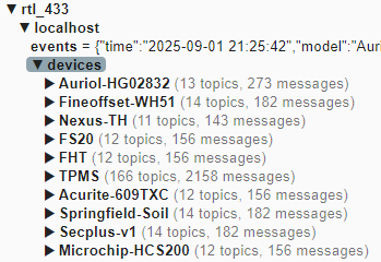

I configured my rtl_433 daemon with following output, as instructed in the addon README:
ExecStart=/bin/sh -c '/usr/local/bin/rtl_433 -F mqtt://X.Y.Z.Ź:1883,user=user,pass=pass,retain=1,devices=rtl_433/localhost/devices[/type][/model][/subtype]/C[channel:0],events=rtl_433/localhost/events -Y autolevel -Y minmax -Y magest -M level -M noise -M time
Then in the addon config I provided:
rtl_topic: rtl_433/localhost
device_topic_suffix: devices[/type][/model][/subtype]/C[channel:0]
but nothing is happening.
In the addon log there is nothing more than this (plus some “pings” after turning on DEBUG):

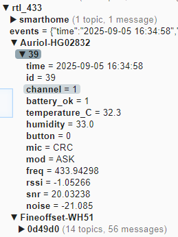

In act of desperation I had a run with ChatGPT about this. It led to simplifying the rtl_433 output configuration, so it looks like this now:
-F mqtt://IP:1883,user=user,pass=pass,retain=0,devices=rtl_433[/model][/id],events=rtl_433/events
And gives following MQTT output:
But regardless of mqtt_topic and device_topic_suffix values I was suggested nothing worked :frowning: Couple of examples:

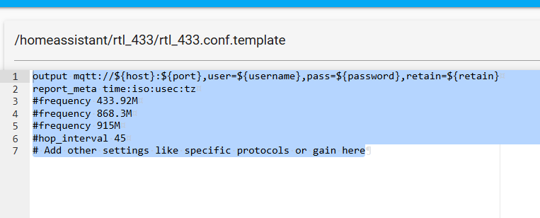

Sorry for the late response. Here is my yaml for rtl_433:
rtl_433_conf_file: ""
retain: true
