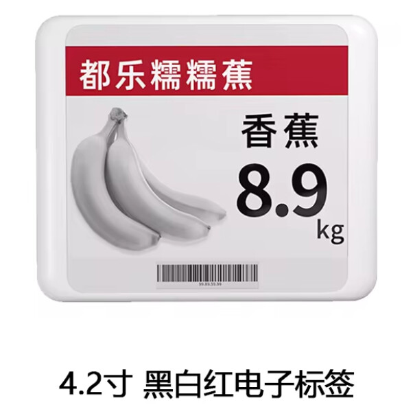

4.2 inch epaper tag
https://www.aliexpress.com/item/1005002399342939.html
That tag looks like exact format, what else do I need on hardware side?
Or, is there any similar project to follow how to?
You can flash the tag with a new firmware that should make it compatible with any bluetooth radio in HA.
Or keep the firmware stock and use a ESP32 S3 flashed with OpenEPaperLink BT only firmware and it can communicate with the tag.
