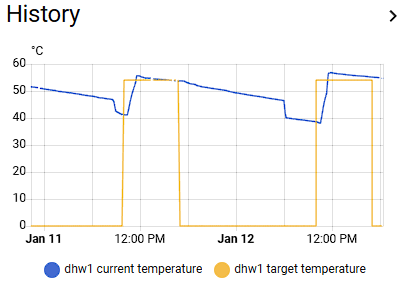

When I put the dhw1 entity onto a dashboard, it draws lines for current temperature and target temperature:
But when I look at the entity in Develper Tools > States, I do not find the target temperature. I can only see these:

It is the temperature. But it is 0, probably because it is off.
Thanks, drawing a graph for that attribute seems to confirm that.
