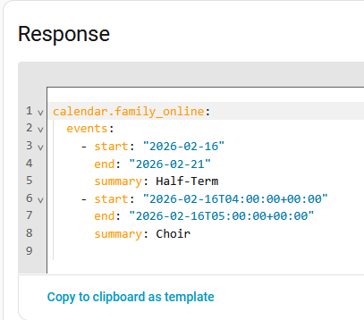

even if I try calendar.family_online I cannot get to the event’s attributes. When I use the actions tab in the developer section of home assistant i get also the correct result (not tried to access the attributes for testing there)
