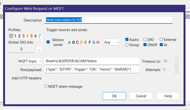

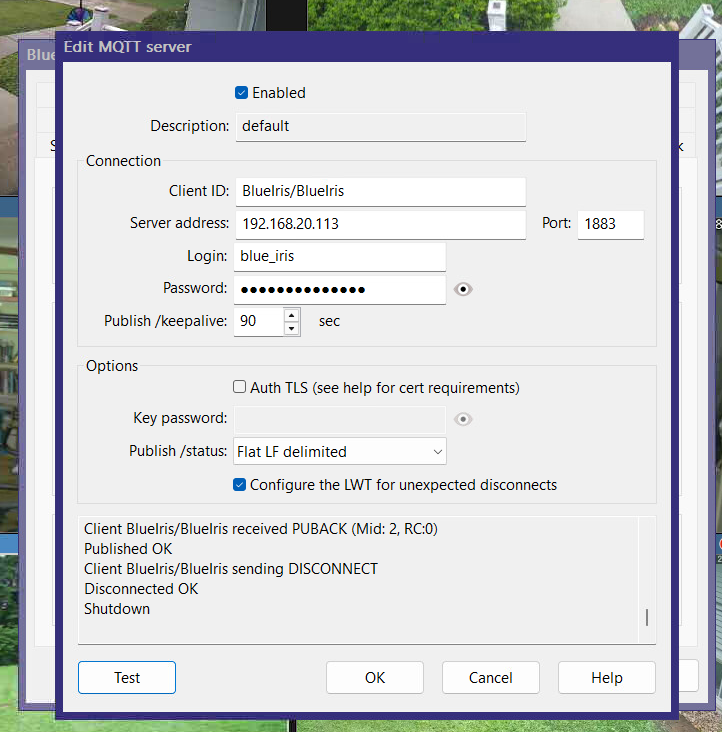

I have gotten BI to feed the motion alerts to HA via MQTT. I must have the format wrong, because the entities don’t update as expected. Here are the Blue Iris parts:
The required Client format ID has changed. It was a single word, typically “home” or “BlueIris” depending on your BI server name. But now it goes one level deeper so multiple BI servers can connect to a single HA server.
This is the “on trigger” action for camera “doorbell”. It follows kramttocs’ integration manual exactly, and is different from the older guides on YouTube:

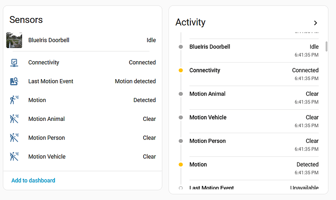

And here is the result:

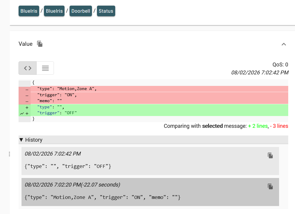

Note that there is a “BlueIris/BlueIris/Doorbell/Status” topic, as expected, and also a “BlueIris/Doorbell/Status” topic, and I don’t know what generates that one.
The Blue Iris integration only registered two of the seven motion events that BI sent from the Doorbell camera. It didn’t register any of the triggers from FrontDoor.
