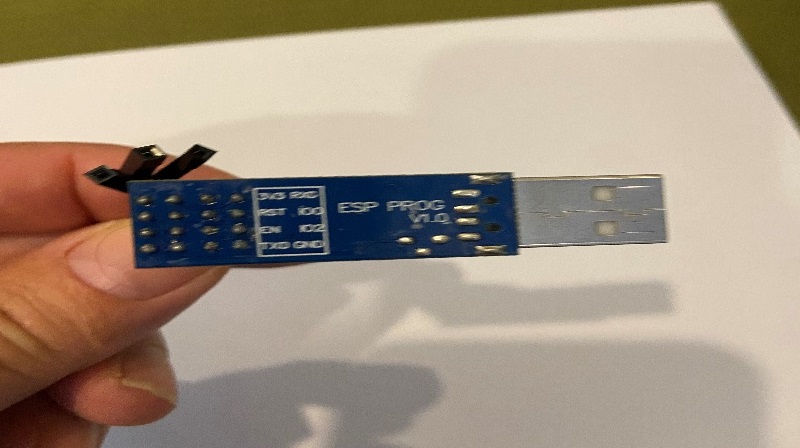

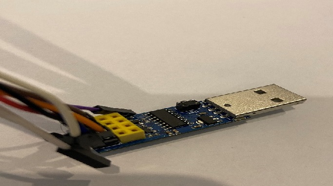

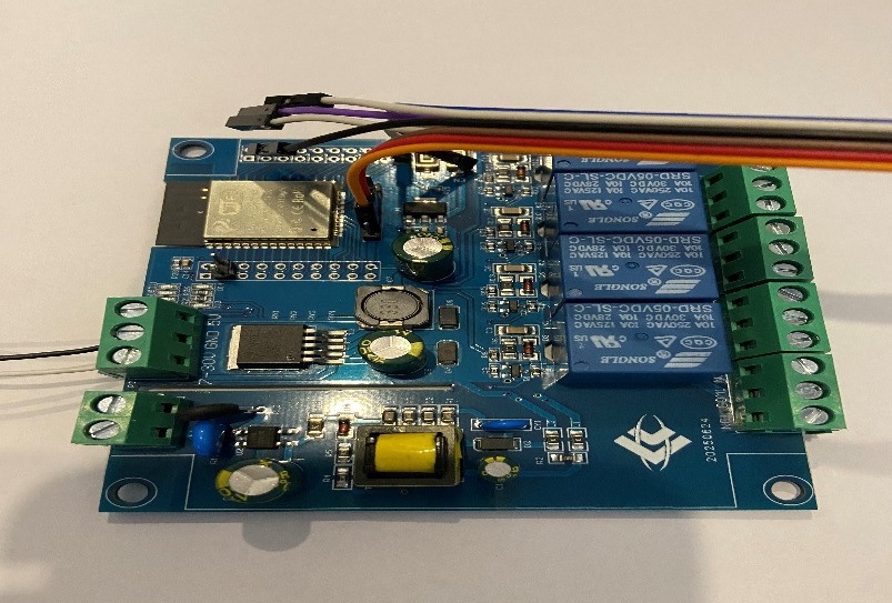

Hi all, I’ve been banging away at this for a week and I just can’t get anything to flash a basic initial code to the ESP board to get started. I have a USB - UART “ESP PROG V1.0” connected to my 4 way relay board which has the ESP32-32E. Wiring connected as
UART - ESP
TxD - Rx
RxD - Tx
GND - GND
3V3 - 3V3
USB board is connected directly into computer (no cables). ESP board powers up OK from the 3V3 source. LED indicators show a “Knight Rider” sequence as the pre-programmed code. USB Serial always shows up as the correct COM port to program on the computer. What I’ve tried -
With and without connected across I00 and EN pins from the USB - UART
Without I00 and EN connected, press EN then hold I00. The ESP appears to enter download mode (no knight rider) - single led lights but no download success.
Insert USB while holding I00, release I00 pre and post trying to download, still no luck.
Reversing Tx and Rx wiring.
External 5V power supply.
Tried ESPHome Builder, ESPLaunchpad, web.esphome, esptool in cmd.
Tried a few different versions of CH34x driver.
Tried 2 different computers

That programmer is built to plug esp-01 to the header and the pin labeling matches with esp pins. So you need to use tx-tx and rx-rx connection. Connect gpio0 to GND while programming.
Hi Karosm,
I had tried that but without holding IO0. So that did it. Thankyou so much. :pray:
