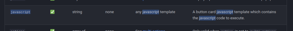

Are you sure actions is the correct key there...? All the examples in the docs show javascript:
