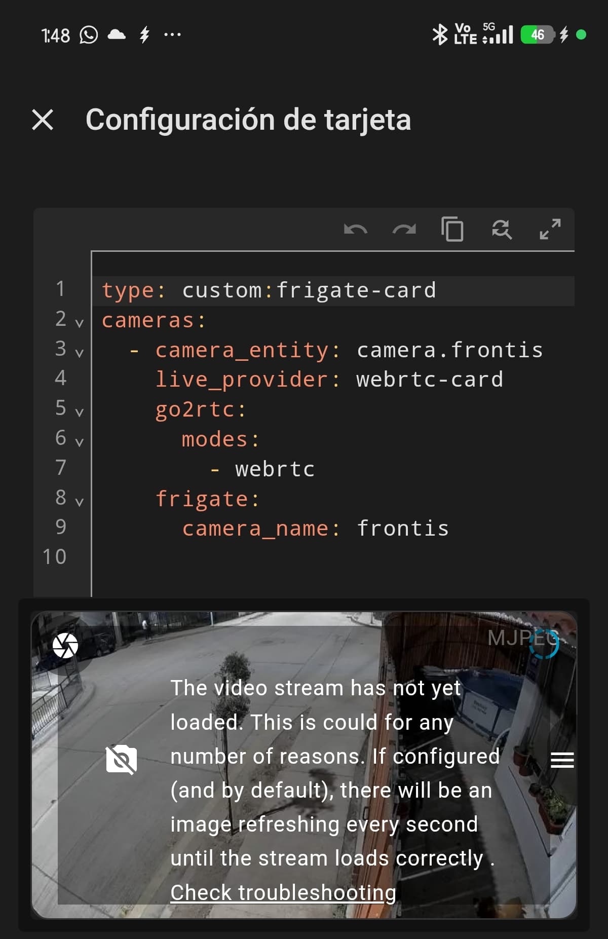

Can't get frigate cameras entities to play webrtc
I’m looking for help to get frigate or advanced camera card to work with my frigate streams inside HA.
The problem is when I select the camera entity inside any card, it only plays a mjpeg stream, which it shows a “1 FPS” preview, I mean, only 1 snapshot of the camera per second and not the video itself:
When I create a webrtc card and selecting directly the go2rtc stream name, the video streams correctly, so, I believe the entity that the frigate integration is creating, does not have the video streams within:
type: custom:webrtc-camera
url: frontis_main
mode: webrtc

The docker container is in host mode, and I’m able to play the streams using the go2rtc interface at 192.168.1.3:1984.
Anyone has experienced this before? I’ve seen some videos on YouTube showing that the integration works straight when selecting camera entity created by the frigate integration.
Any help will be appreciated!
