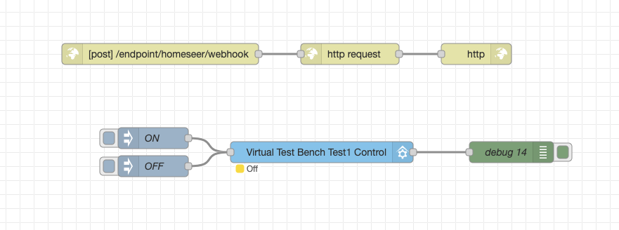

You could perhaps try something like the following to work around the authentication requirement… create three nodes:
┃ 1. http in ┣━━━┫ 2. http request ┣━━━┫ 3. http response ┃
  1. Method: POST
    URL: /homeseer/webhook
  2. Method: POST
    URL: http://localhost:1880/homeseer/webhook
    :white_check_mark: Use authentication
    Type: basic authentication
    Username: <username>
    Password: <password>
Then you could use http://172.29.1.10:1880/endpoint/homeseer/webhook for the webhook. This would be routed through httpNodeRoot which doesn’t require authentication and be processed through the nodes above. The second node will forward the request back to Node-RED via httpAdminRoot with authentication.
It’s a bit of a hack but maybe what’s needed.

Brilliant. THANK YOU! That works perfectly.
It took me a minute to think about what it was doing but now I understand it.
