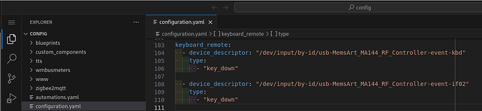

In lstria1704’s configuration.yaml:
device_name: "/dev/input/event3"
I think it should be:
device_descriptor: "/dev/input/event3"
I just migrated from Raspberry Pi 3 to HAOS in VM on Proxmox 8 on an intel NUC.
After thinking I had the same issue and finding this thread I realized I forgot to add the config in the yaml file :smiley:
Here’s what I’ve done:
  1. I plugged my RF remote dongle
  2. I enabled pass-through via the device ID
  3. I verified HA can see the remote as a keyboard:
  4. I configured the keyboard in the configuration.yaml file:

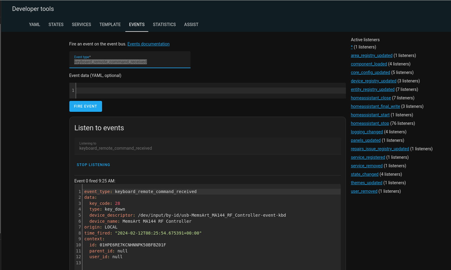

  5. I tested in the events tab of the developer tools by listening keyboard_remote_command_received and pushing keys on my remote:
I hope that helps.
