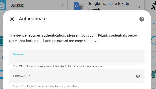

I ended up using HA’s Tapo integration and setting up the device with the Tapo App on a Wifi that does not communicate with the outside world. Once the device is on the Wifi, use the Tapo integration, enter the ip address of the switch and done.
I have 2 other dimmers sitting in a box. I hope the provisionning will also work for them.
hey that’s interesting… when i tried the integration called Tapo, it directed me to the tp-link smart home integration; and then it asks for a user/account – is that what you did?
Yup.
I used my tp-link creds ( Tapo is basically tp-link as far as I know ).
But I am certain the device is on a network without internet access, and with HA you xan manually turn off the orange LED on the switch.
I think the credentials are set in the device’s web server and is required to control it properly :person_shrugging:
thanks for clarifying.
Yes, that worked for me as well.

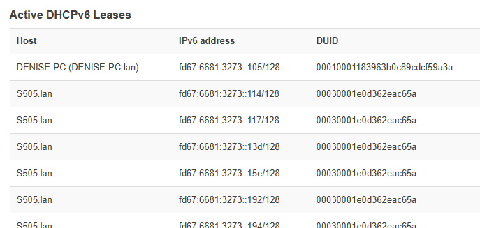

I don’t understand IPV6 and it gets me wondering if that has something to do with my matter problem… AFAIK it’s all turned on and enabled.
I wonder why, e.g. in my router there are DOZENS, 73 at last count, of active DHCPv6 leases for the tapo device??
