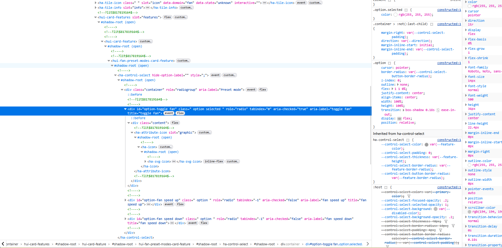

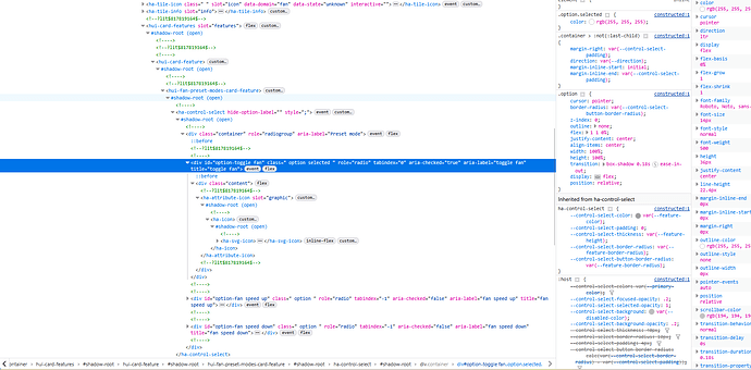

This is the screenshot of the inspector page:

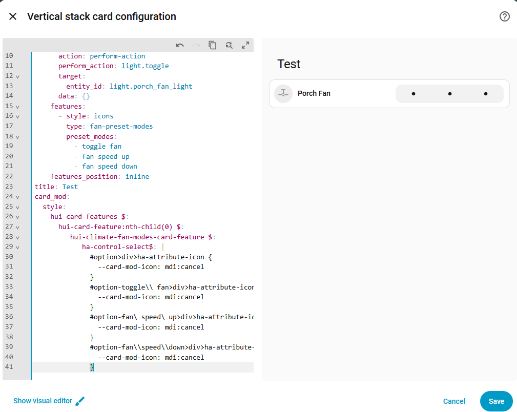

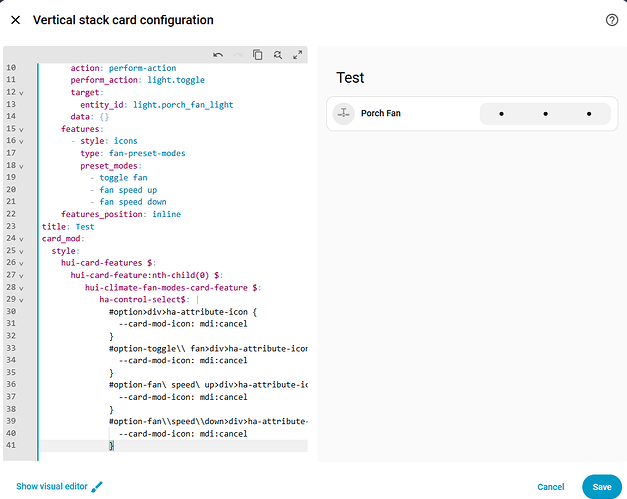

One of those hundreds of variants I tried (addiing div, removing div, adding dollar signs, removing dollar signs etc.):
card_mod:
  style:
    hui-card-features $:
      hui-card-feature $:
        hui-fan-preset-modes-card-feature $:
          ha-control-select $:
            div div div ha-attribute-icon $: |
              ha-icon {
                --ha-card-background: teal;
                --card-mod-icon: mdi:fan-speed-1

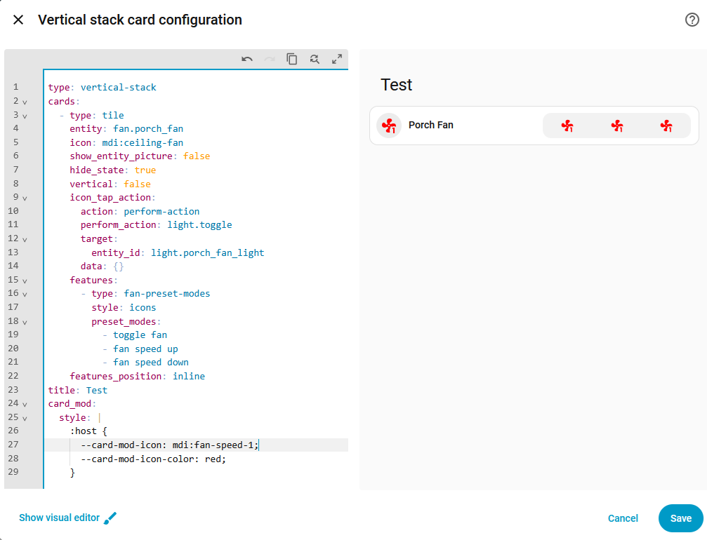

card_mod is installed and working - I can replace a background or icons on the whole tile using generic CSS, but those specific DOM elements. What am I doing wrong?
If I do the on the for the :host element
card_mod:
  style: |
    :host {
I am getting this
but when I try to use DOM path (even obtained via the card-mod-helper:
"body>home-assistant$home-assistant-main$ha-drawer>partial-panel-resolver>ha-panel-lovelace$hui-root$#view>hui-view>hui-masonry-view$#columns>div:nth-child(3)>hui-card>hui-vertical-stack-card$#root>hui-card:nth-child(5)>hui-tile-card$ha-card>ha-tile-container>hui-card-features$hui-card-feature$hui-fan-preset-modes-card-feature$ha-control-select$#option-toggle\\fan>div>ha-attribute-icon"
and use with this config:
card_mod:
  style:
    hui-card-features$hui-card-feature$hui-fan-preset-modes-card-feature$ha-control-select$: |
       #option-toggle\\fan>div>ha-attribute-icon {
nothing works. No matter what I do to this path. Even though this guy was in the same situation and got it :puzzle_piece: working

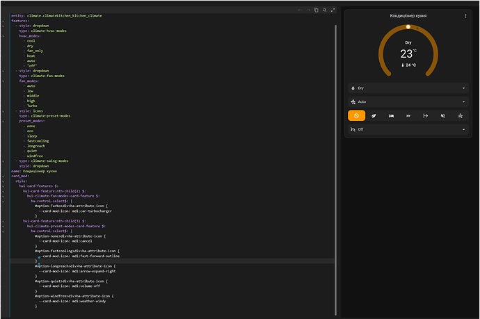

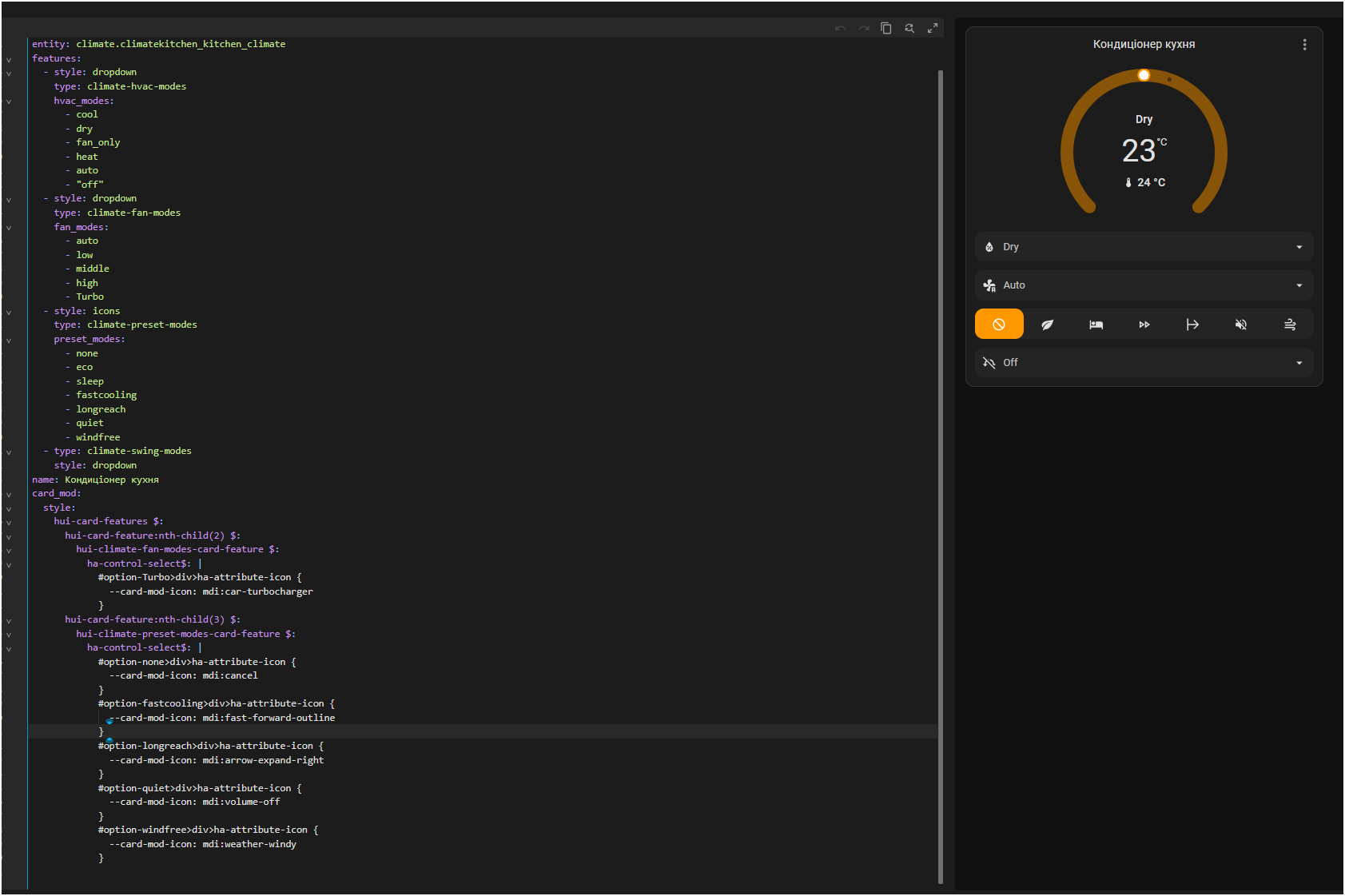

Hi Vlad,
This is how it worked for me after all
card_mod:
  style:
      hui-card-feature:nth-child(2) $:
        hui-climate-fan-modes-card-feature $:
            #option-Turbo>div>ha-attribute-icon {
              --card-mod-icon: mdi:car-turbocharger
      hui-card-feature:nth-child(3) $:
        hui-climate-preset-modes-card-feature $:
            #option-none>div>ha-attribute-icon {
              --card-mod-icon: mdi:cancel
            #option-fastcooling>div>ha-attribute-icon {
              --card-mod-icon: mdi:fast-forward-outline
            #option-longreach>div>ha-attribute-icon {
              --card-mod-icon: mdi:arrow-expand-right
            #option-quiet>div>ha-attribute-icon {
              --card-mod-icon: mdi:volume-off
            #option-windfree>div>ha-attribute-icon {
              --card-mod-icon: mdi:weather-windy
PIC:

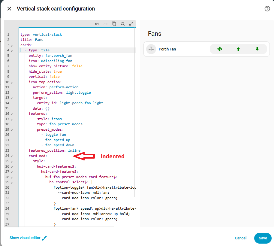

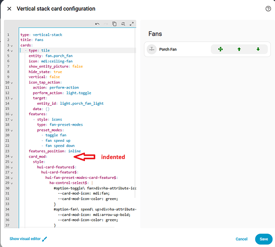

After a few days of struggling, I finally got it working with the following code. Note a single backslash prior to each space in #option- card-mod-helper doesn’t seem to translate them correctly.
card_mod:
  style:
    hui-card-features$:
      hui-card-feature$:
        hui-fan-preset-modes-card-feature$:
            #option-toggle\ fan>div>ha-attribute-icon {
              --card-mod-icon: mdi:fan;
              --card-mod-icon-color: green;
            #option-fan\ speed\ up>div>ha-attribute-icon {
              --card-mod-icon: mdi:arrow-up-bold;
            #option-fan\ speed\ down>div>ha-attribute-icon {
              --card-mod-icon: mdi:arrow-down-bold;
Another issue was that the URL under the extra_module_url in configuration.yaml should exactly match to what HACS lists under the Resources for the card_mod. Somehow I thought it should be /local/community/…
  extra_module_url:
    - /hacsfiles/lovelace-card-mod/card-mod.js?hacstag=<number>
One more important thing - I have a few tiles wrapped up by the vertical stack. This code only worked when defined on the tile level (i.e. indented to be on the same level as a tile), not the vertical stack level.
Don’t ask me why… maybe DOM path needs to be defined differently, maybe something else. I’ve had enough, don’t want to play with it anymore.
