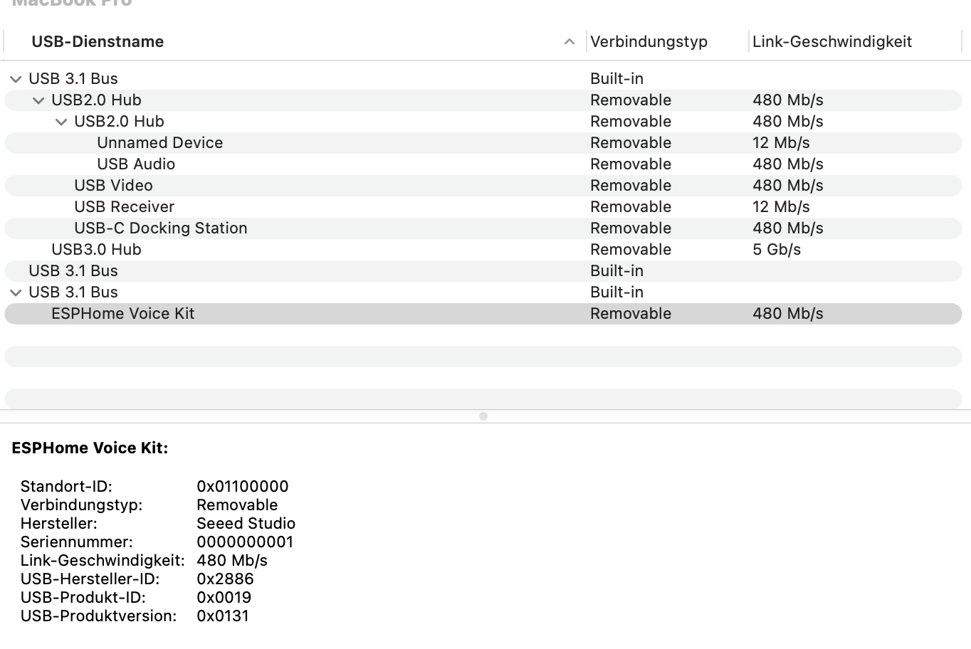

I can see that the device is recognized in “system information” on my Mac and and also in the device manager on my windows machine when I connect it there.

Opened the case to see it there are UART Pins to flash it in another way and found a switch labeled “USB-Select”, which was in the wrong position. :face_with_spiral_eyes:
Worked fine now. :slightly_smiling_face:
