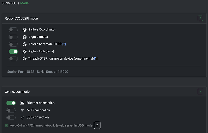

I'm using a SMLight Controller. when set to controller I can't adopt devices in the SMLight interface. I need to set it to hub mode to be able to pick up devices.
without being onboarded it does not talk from zigbee to zigbee2mqtt and then to mqtt.
so all I have atm is smlight needing to be in hub mode and pointed directly at my mosquito.

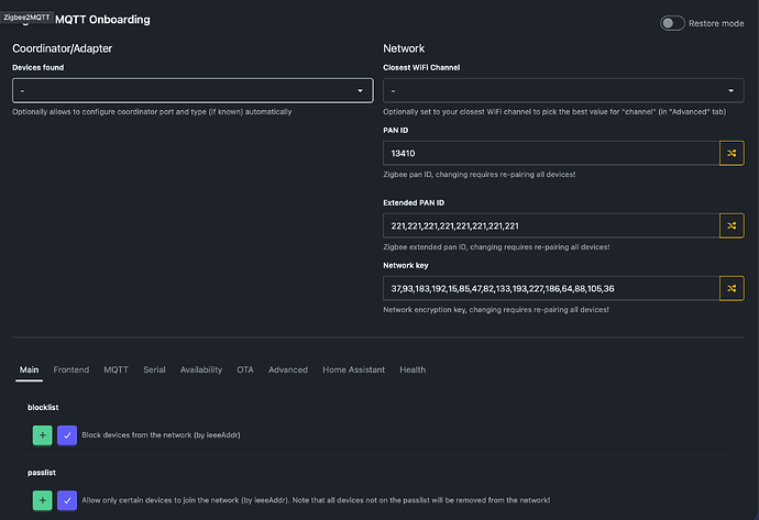

G

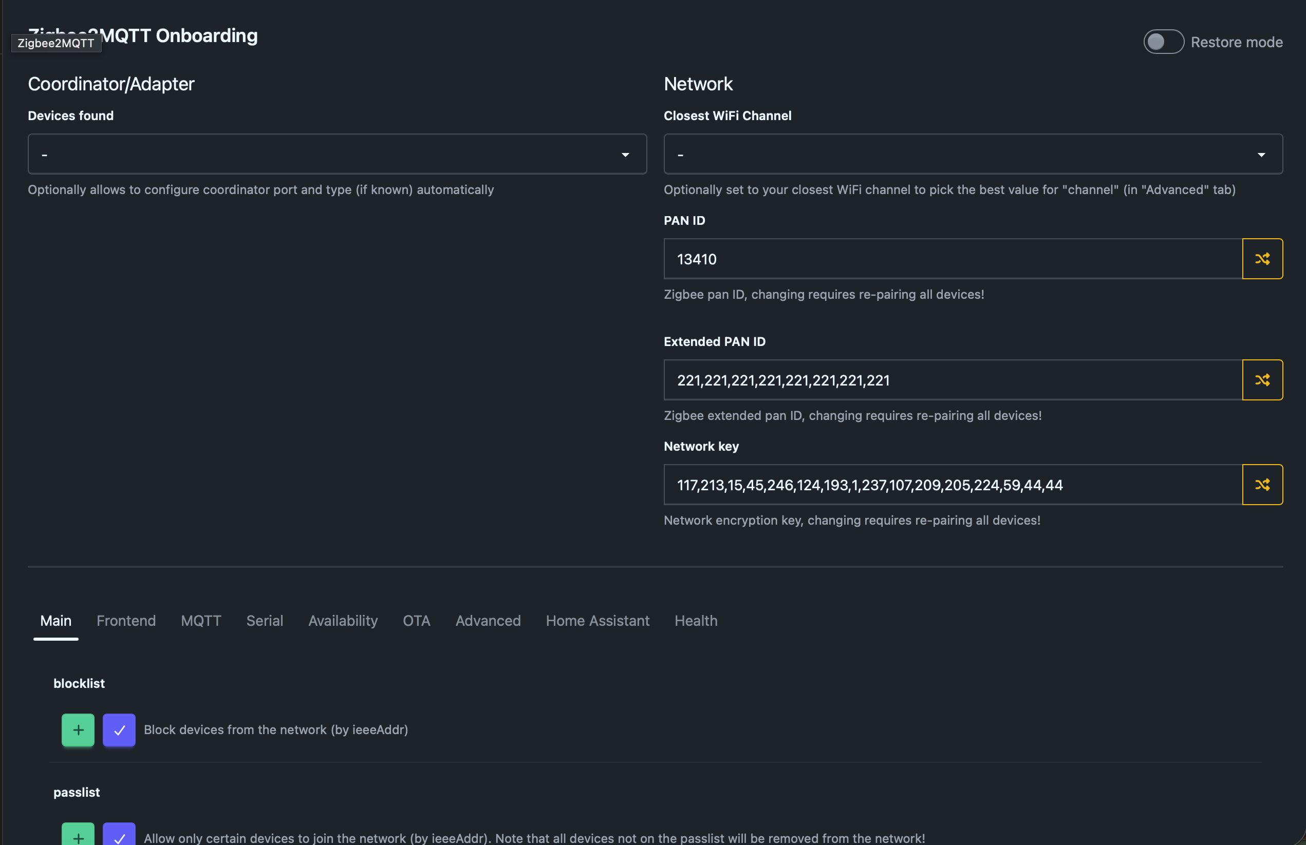

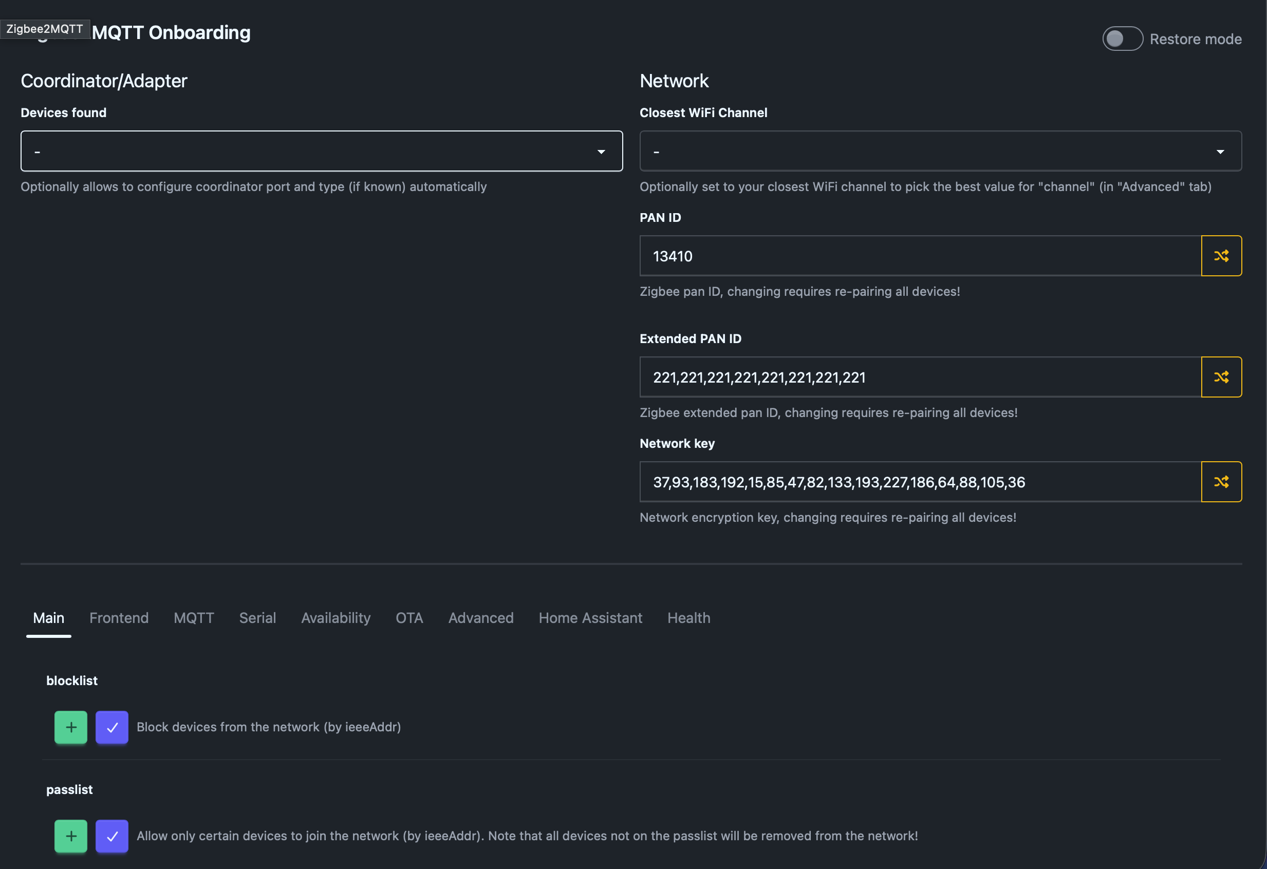

What I am stuck with
What I expect to see once onboarded.

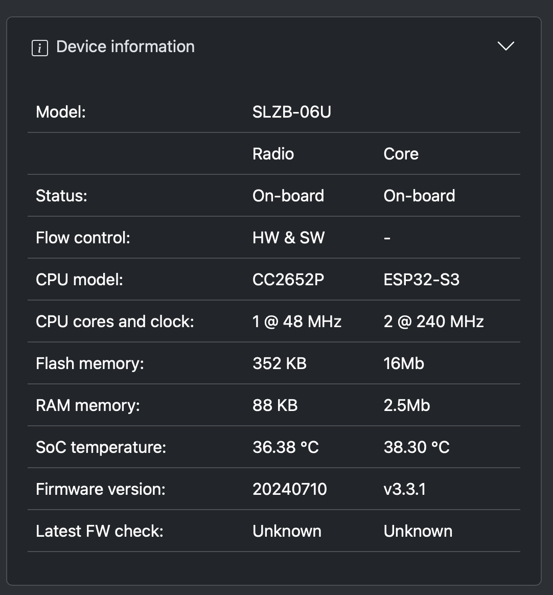

What SMLIGHT device are you using?
WAS: Your current firmware revision: 20240710
UPDATED: Your current firmware revision: 20260311
What are your mode settings?
At the moment, to be able to do anything, it's on HUB, if I set it to Coordinator, no difference, the onboarding screen just comes back to have to onboard.
with it on hub, I could at least adopt the local devices for now. to make sure they are working/talking to the smlight.

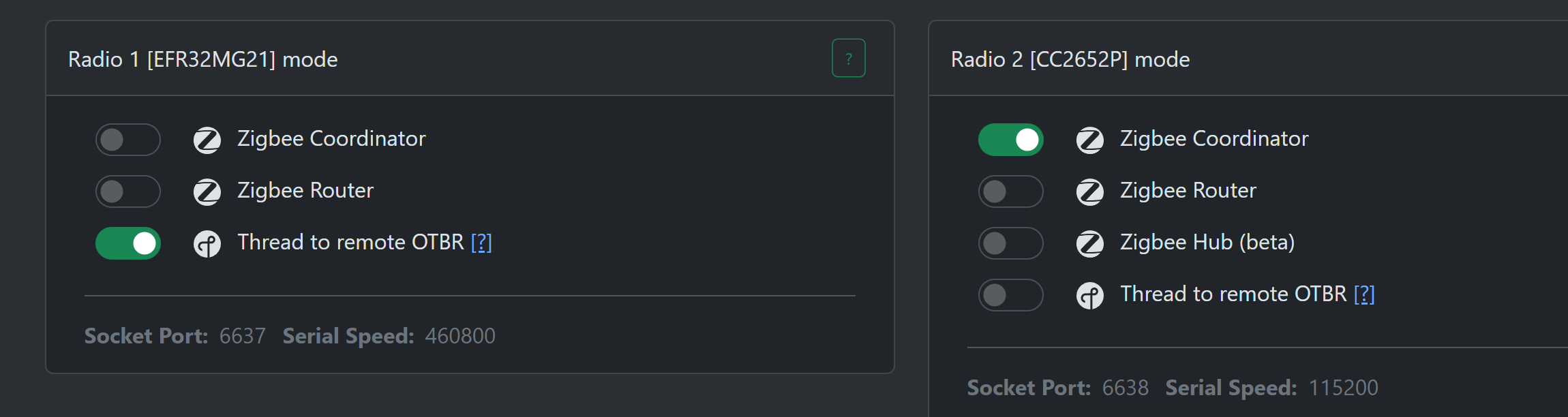

I feel your pain, but the los is only in Hub Mode. As a coordinator, FW updates won't reset your devices or require re-pairing.

... problem, now. how do I pair if back in Controller mode, as I can't get Zigbee2MQTT pass the onboard page.
G
The onboarding isn't necessary and can be disabled in your config
onboarding: false

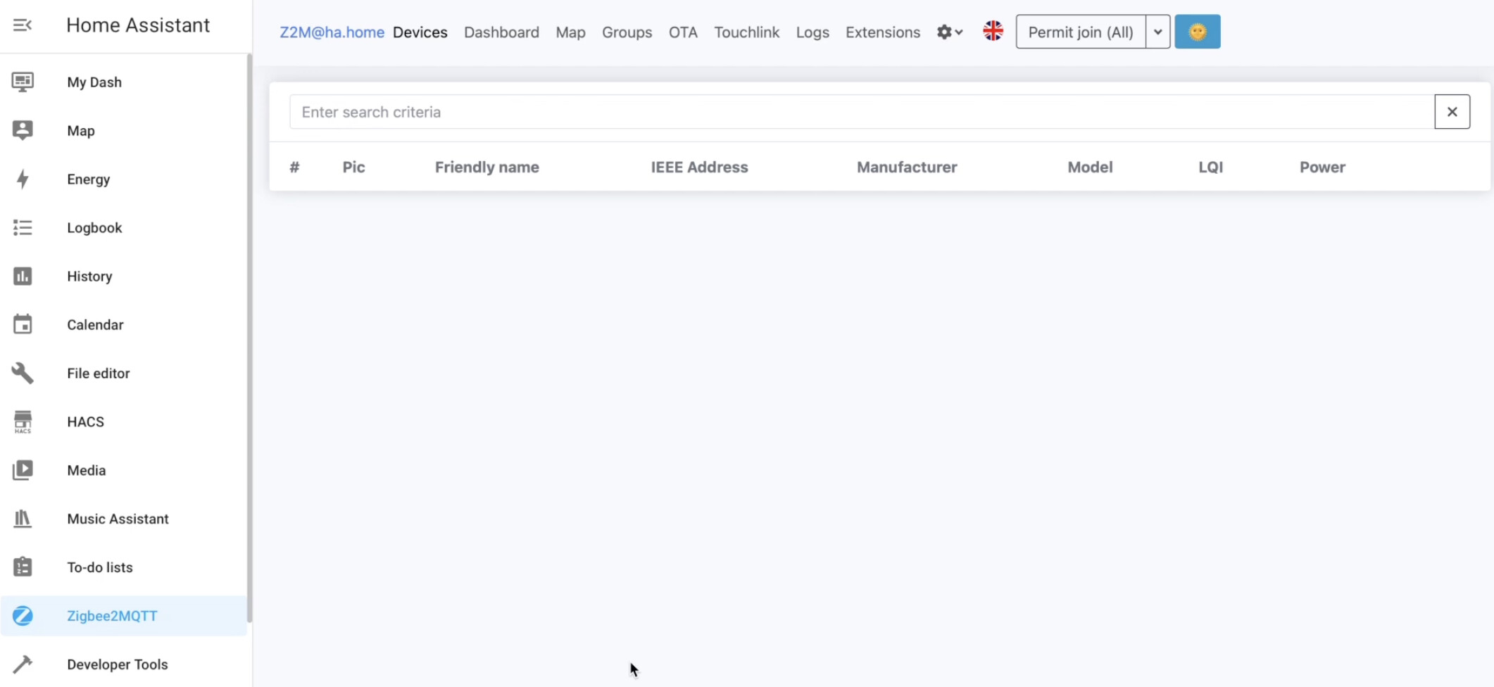

added to config, restarted app. it still opens to this page, with no map or devices tab.
Let's back up a bit. How is Z2M integrated in HA? Via the Apps tab?
HA appears to not see your coordinator which points to Z2M config issues.

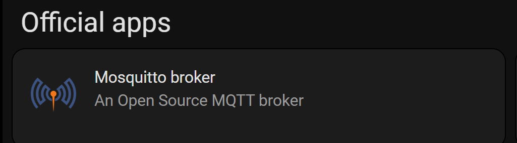

You have MQTT broker installed, correct?
Other threads where I explained the process
yes, Mosquito is installed, locally.
