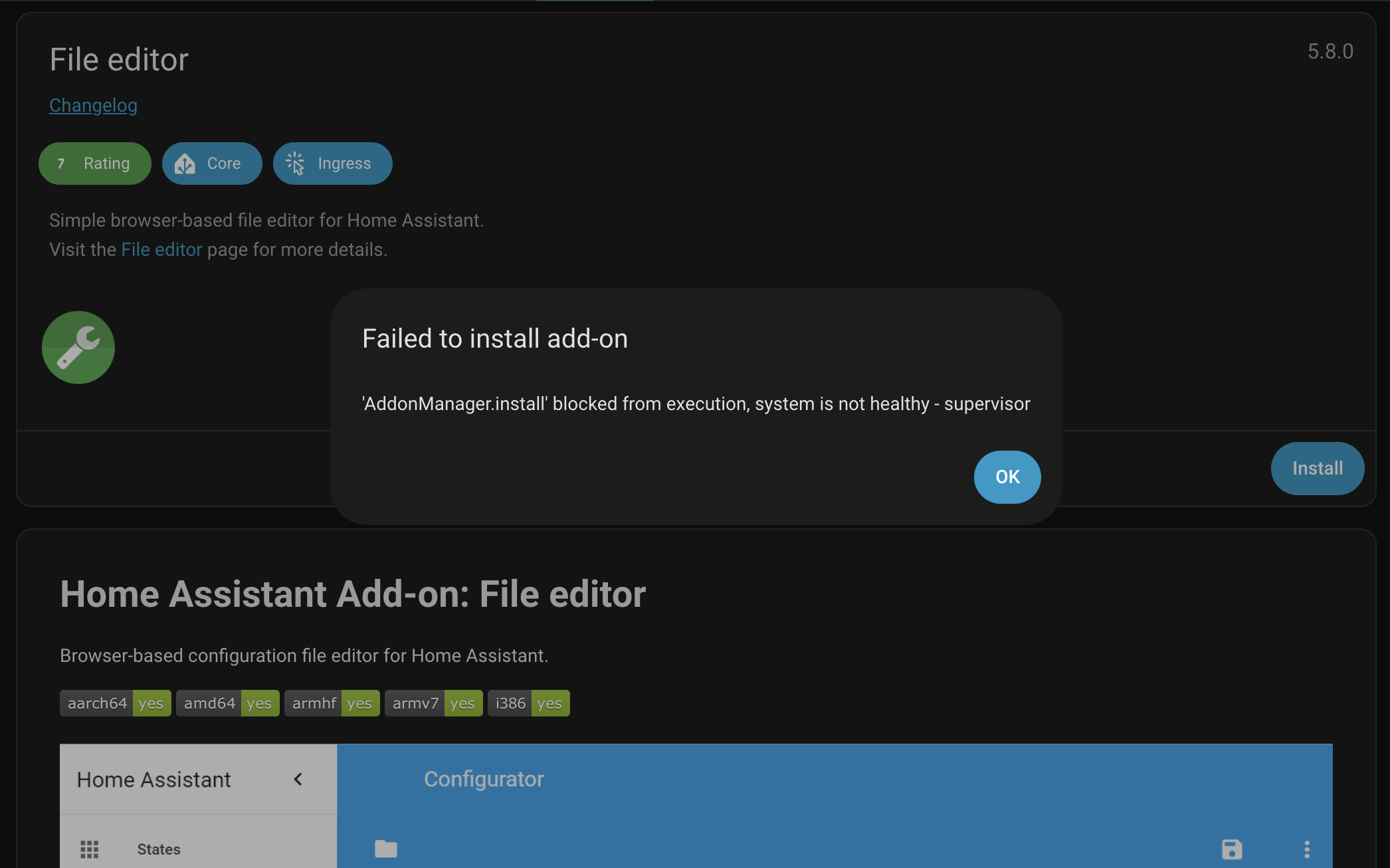

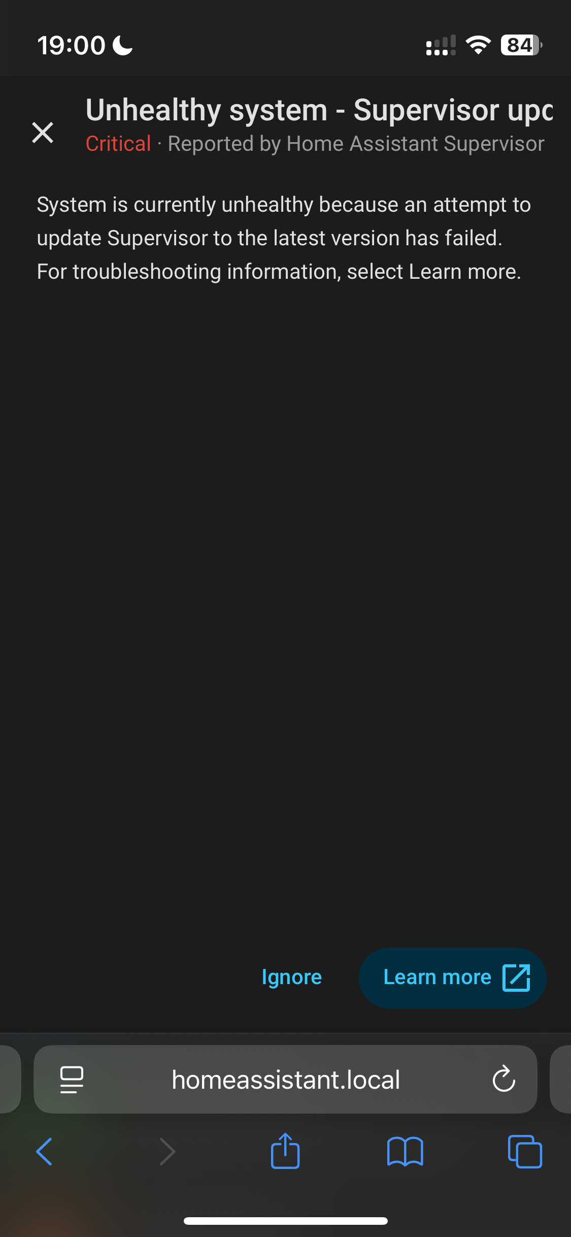

I’m aware that armv7 (and therefore my Raspberry Pi 2 Model B) is unsupported with the upcoming release and that that means I can’t update my supervisor, but I don’t understand why that blocks me from installing add-ons on this still supported version of core-2025.11.3.
Any idea on how to get rid of the 'AddonManager.install' blocked from execution, system is not healthy - supervisor error?

That’s a good idea and I was considering it, the thing that surprises me is that the system only became “unhealthy” and “unsupported” after the supervisor upgrade (as intended) failed. Now I can’t seem to get out of this state which in turn prohibits me from installing add-ons.
