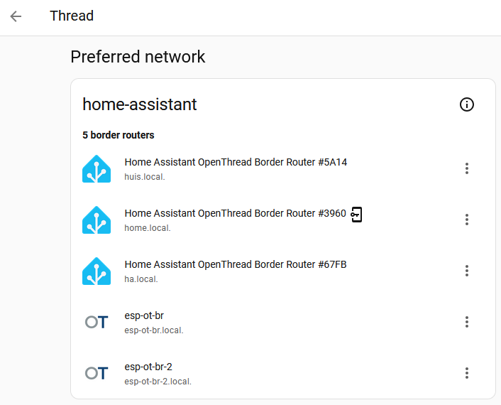

Do you have a key next to your border router ?
I do have a key next to my single entry, yes. I’ll admit to having forgot to do it the 2nd time around but I just did and it said “You have no credentials to send” then the entry reappeared with the key next to it.
I tried re-adding, still a no go :frowning:
Okay I kinda fixed it… Went to:
In the Companion app, go to Settings > Companion app > Troubleshooting , then select Sync Thread credentials .
That did the trick. The device started pairing normally after that. Ofc it ended on a “Something went wrong” message, but the device is now visibile in ha and has 8 entities assigned to it.
