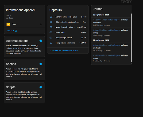

I’ve recently purchased tado X wireless boiler smart thermostat + radiators thermostats. However the HA integration doesn’t seem to provide entities for the rooms that I setup.
I know tado X can integrate devices through Matter but I don’t want to integrate each devices. I want to be able to control the rooms defined in tado in HA.
Am I missing something or is the Tado integration not supporting Tado X yet ?
Thanks a lot for your help.
HA integration :

The integration does not seem to publish the expose the rooms as area in my case.
Can you see the individual devices? Since I switched to tado x, and logged in with new login, I don’t see devices linked to tado X bridge.
I’d don’t see anything, no individual devices no areas. I think for individual devices you’re supposed to connect via matter but I want to see areas no devices.
