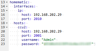

I’m running a Raspberrymatic and connected it to Home Assistant using the integration with this configuration:
I’ve set up my first automation trying to set a variable inside Raspberrymatic when the outdoor temperature of an integrated Ecowitt Witboy has changed.

When executing the action a succes message is displayed but the vasriable in raspberrymatic isn’t changed.
You should switch to the Homematic_Local integration instead.
It is far better maintained and the HA devs even recommended it over their own at one point.
Thx for pointing me to this integration. This is way better than the other one. On my journey installing HACS and the integration I’ve learned a lot of the concepts of Home Assistant!
