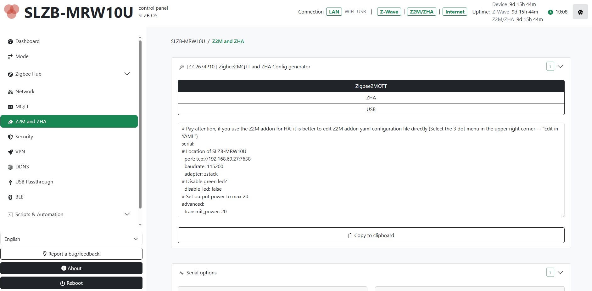

You have 2 ports there, so that’s at least 1 of your issues. Also, I’m pretty sure that the frontend should have HA’s IP, not your MR1U one. Should be 192.168.1.182:8099.
Z2M now has an onboarding screen in the UI which makes it pretty hard to mess up. I suggest you remove the yaml config for Z2M, restart & do the setup from the onboarding screen.
On my SLZB firmware, they give you the yaml for z2m config.
However, looking at my own config, there is an extra line: data_path: /config/zigbee2mqtt and I’m not really sure what it is for. Maybe config save location?
Anyway, you should be good with this:
mqtt: {}
serial:
  port: tcp://192.168.1.6:7638
  adapter: zstack
  baudrate: 115200
Or just paste in the config from the SLZB firmware and see what happens.
Check the baudrate. There are Zigbee FW with two different speed.
