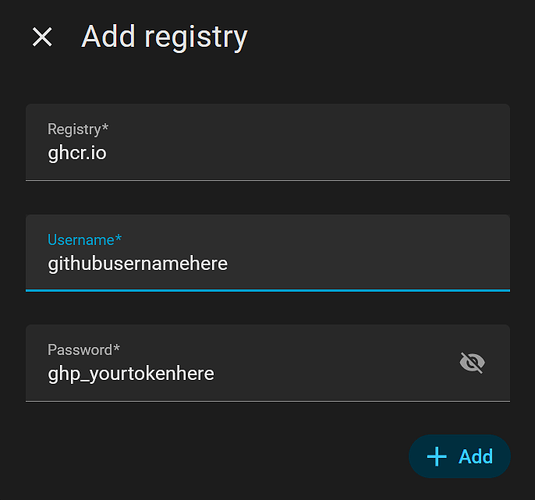

Ratelimits are occurring for the GitHub Container Registry, not the Docker Hub Registry. To fix this, you can follow the same guide as for using Docker Hub credentials for the supervisor, but with a couple differences.
  1. Follow this guide up to (not including) step 4: Docker Hub Rate Limit - Home Assistant
  2. For step 4, enter ghcr.io under Registry. Head to Sign in to GitHub · GitHub and create a token with just read:packages checked only, then set an appropiate expiration date and name. Enter your GitHub username in the Username field, and in the Password field, put in your token. Click Add then try updating Supervisor/Core again!

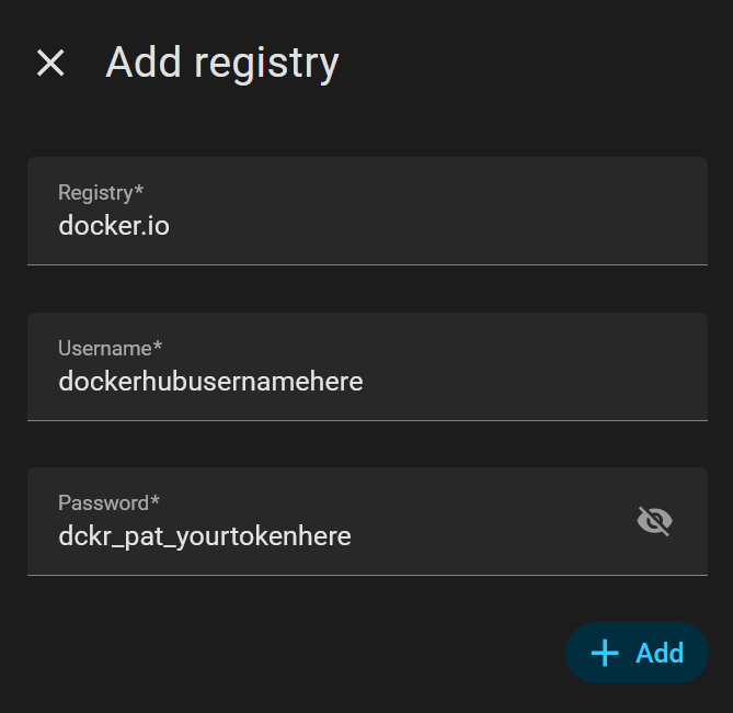

I also did the same for Docker Hub to avoid future issues. Just follow the guide, except don’t follow the screenshot on the docs, specify docker.io as the Registry, NOT hub.docker.com. Additionally, you can generate a token for usage instead of your Docker account password here: https://app.docker.com/accounts/burritosoftware/settings/personal-access-tokens. Set the scope to Public Repo Read-only (should be that by default), create it and set Username as your Docker Hub username and password as the token.
