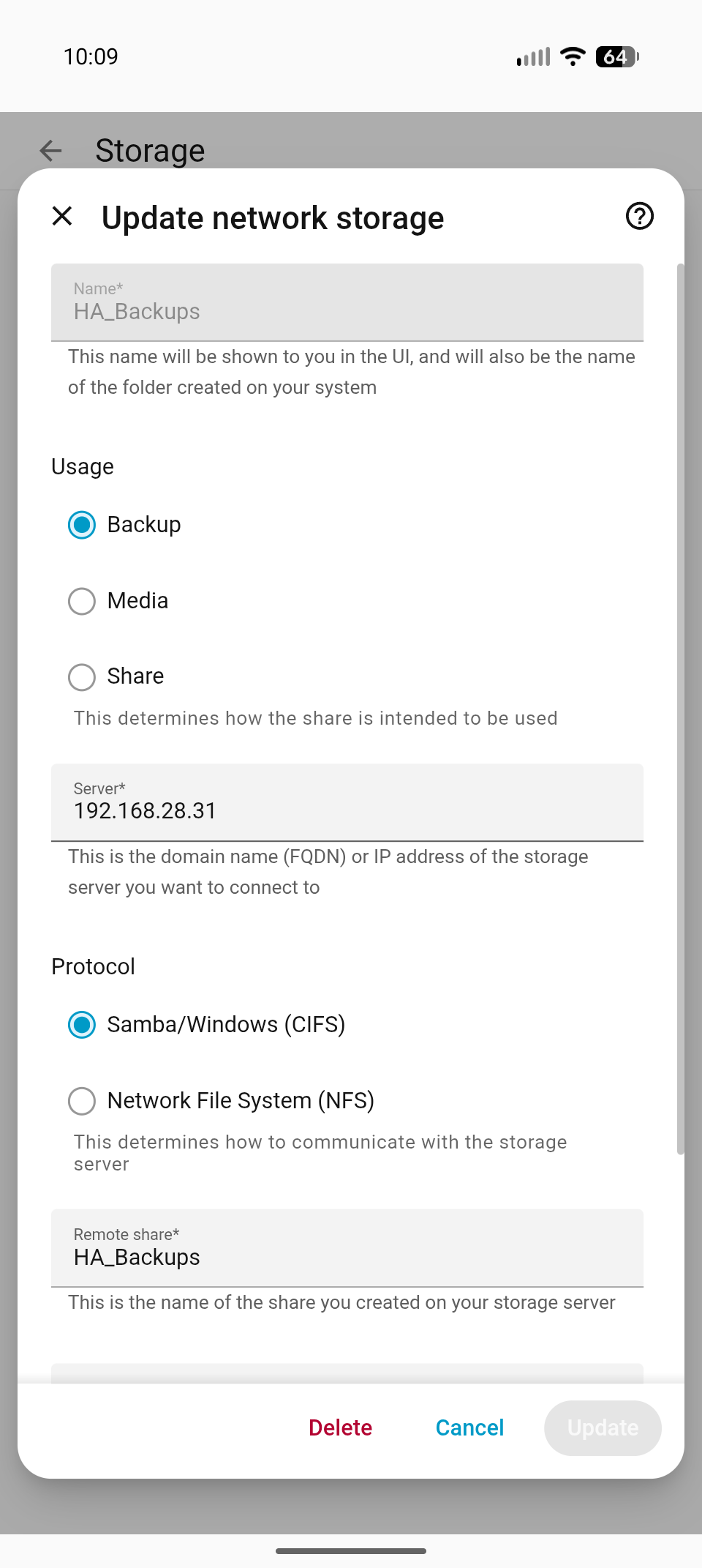

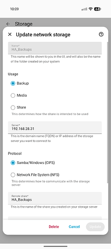

This is why I do a Samba backup every night to another computer. My backups are around 1.3gB.
There are also methods to backup to Google Docs, but I’ve never used them.
Same here. I’ve got everything going to a NAS which is mounted in system > Network. They end up being similar ~1.5gb size and I haven’t had an issue with restoring them. That said, I haven’t done a out of box experience (OOBE)/from scratch restore in a long time. Not sure, how it would be handled without it being mounted to the system.
