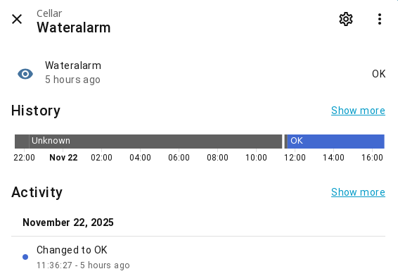

Even if I receive data - the status of the device shows up as “Unknown”.

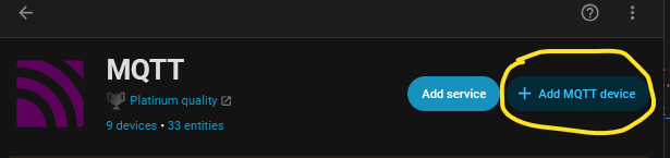

How did you get the ‘device’ to show up in HA ?
Auto-discovery ? Defined a sensor in .yaml ? ‘Add MQTT device’ in the MQTT integration screen ?

That was done using “Add MQTT device” in the MQTT integration screen.
Try to set up a binary sensor as an MQTT device.
Then select Binary sensor. The Payload on and off can be customized. Or you can use a value template.

I managed to add the MQTT-Device and it shows up as “OK” instead of “Unknown”.
So far so good…
