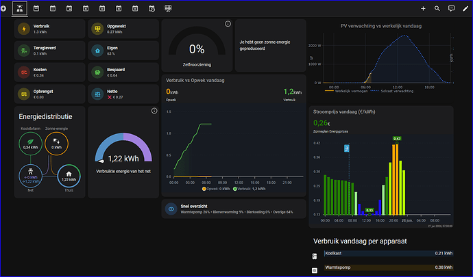

Card background color inconsistent between mushroom-template-card and standard HA cards
I'm using the Mushroom Shadow theme and have a dashboard with a mix of card types:
  • custom:mushroom-template-card
  • energy-distribution
  • energy-grid-neutrality-gauge
  • custom:apexcharts-card
  • custom:bar-card
The standard HA energy cards and bar-card show background color rgb(28, 28, 30) = #1c1c1e which looks great. But the mushroom-template-cards show a slightly lighter grey background, making the dashboard inconsistent.
I've tried:
  • card_mod with ha-card { background: #1c1c1e !important; }
  • card_mod with :host { --ha-card-background: #1c1c1e !important; }
  • Setting ha-card-background, card-background-color and mush-card-background-color in a custom theme yaml
None of these work. The mushroom cards keep their own background color regardless.
Question: How can I force all mushroom-template-cards to use exactly #1c1c1e as background color, matching the other cards on my dashboard?
