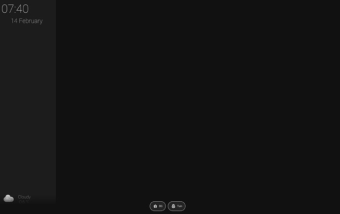

After several hours of troubleshooting with ChatGPT, I hope to have a bit more luck here because whatever ChatGPT tries, nothing works.
I just started creating a dashboard that is displayed on a tablet that I mounted on the wall, I use 3 main components at the moment, sidebar, bubble-card and weather card.
I made 2 pop-up buttons on the bottom of the screen, there is some gradient effect behind it, the issue is, this effect also goed over the sidebar and weather card, I would like to place the weather card on top of the bubble card so the gradient effect won’t effect weather card.
My code look likes this:

Here are some picture how it looks at the moment:
Whatever ChatGPT tries, the card will disappear when it tries to fix it. Who knows the answer to this issue?

Thanks for the quick reply and tip, I adjusted the style blocks according the suggested method, but still, the weather/bottom card is behind the gradient effect
