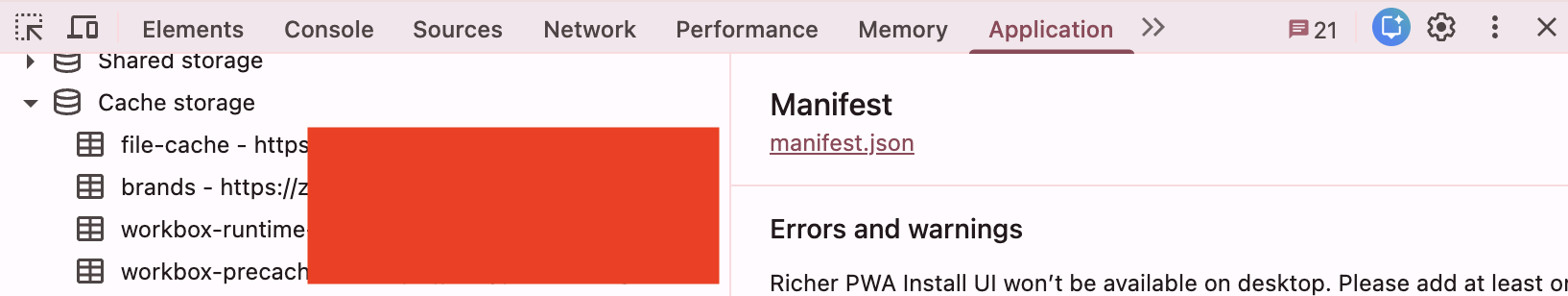

Home Assistant ‘Frontend’ caching
Home Assistant uses a service worker that uses Browser cache storage. It calls the Cache storage file-cache (there are some others as well). This is not to be confused with the Browser’s general cache which will still be used if a request is not in file-cache. I have included a screenshot below to show how you can review what is in this cache. These are the caches that the new card-mod clear_cache action clears, and also these same caches are also cleared (as well as localStorage etc.) when you use the Troubleshooting section of Companion App.
