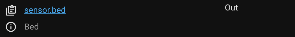

What am I doing here to not get the color to change:
entity: sensor.bed
card_mod:
  style: |
    :host {
      --card-mod-icon-color:
      {% if states(config.entity)=='In' %}
         gold
      {% endif %}
         none
If I change it to this:
card_mod:
  style: |
    :host {
      {% if states(config.entity)=='Out' %}
         none
      {% endif %}
         gold
The colour works but the colour stays even when. “out”:
The capitilsation is right:
So I am unsure why it won’t work

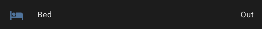

It’s If Else Endif
card_mod:
  style: |
    :host {
            none
         {% else %}
            gold
         {% endif %}

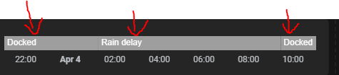

Hi folks.
Any chance of applying custom colors to history-graph? My mower has same gray color for multiple states - docked, charging, rain delay, I want to separate them. Currently only different are error (red) and mowing (turquise).
Tried some tricks with card mod style but cant figure it out.

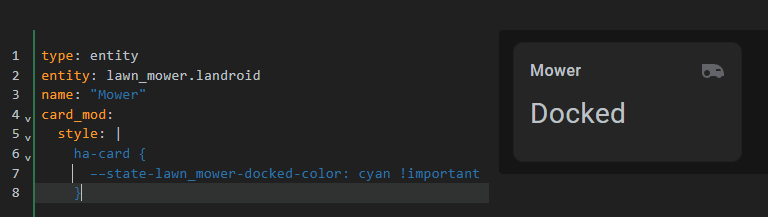

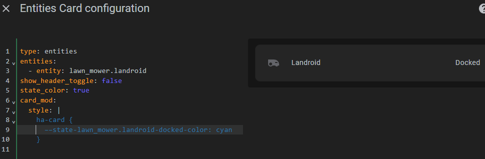

Can’t test with lawn mower myself. So you will do it:
  1. Create Entities card with state_color: true.
  2. Add your lawn_drawer entity onto it.
  3. Add card mod code for the whole card like: ––state-lawn_mower-docked-color: cyan.
  4. Then check with a docked lawn mower is the icon is cyan.
The question is I have no idea is the “lawn_mower” domain is supported for css variables.
Easier to open source code but I cannot do it, no access to PC.
So, if it is supported - then you will be able to define custom colors for lawn mower.
What is more productive - open Code inspector (F12 in Chtome) or whatever it is called in your browser, define a proper DOM path by yourself to the element you wish to style. Use my example as a starting point to understand how code is defined.
Or keep waiting and using ready solutions made by other people.

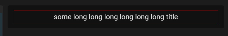

There quite a few ways but his example helps to understand what to target
  .title > p {
            color: red;
            white-space: break-spaces !important;
If you target the actual title text, I believed you would have to use margin-left: 50px !important or text-indent: 50px !important;
or target the container of the text and use justify-content: center !important;
type: vertical-stack
cards:
  - type: heading
    heading: some long long long long long long title
    heading_style: title
    card_mod:
      style: |
        .container{
         border: 1px solid red;

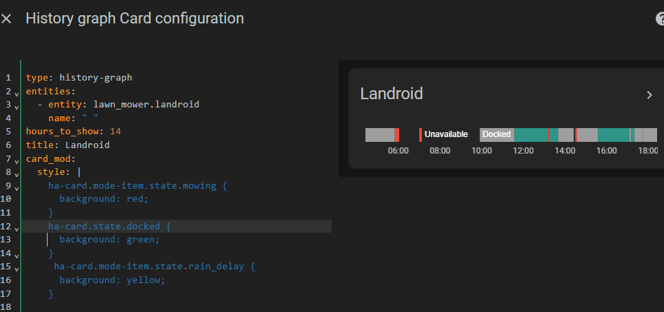

But anyway I wanted to have 14hour history bar with separate states, just custom colored so it doesn’t blend between states.

You tested with Entity card, not Entities with state_color.
I did not propose to change a background.

Nailed it!
I had tried text-align: center in the .container element but when inspecting the DOM I failed to notice it had justify-content: space-between;.
Greatly appreciate your help!!
