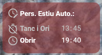

Is it possible to change the icon color based on value of the sensor?
Use jinja.
{% if … -%}
 color: red;
{%- else -%}
color: green;
{%- endif %}

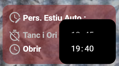

ok so thats great, not sure why i can color the icon but not the value?
card_mod:
  style: |
    ha-card {
    {% set signal = states(config.entity)|int(default=0) %}
      --accent-color: gold;
    .header .name {
      font-size: 46px;
    .header .icon {
      --mdc-icon-size: 40px;
      {% if signal >= 105 %} color:red
      {% elif signal >= 70 %} color:orange
      {% elif signal >= 35 %} color:yellow
      {% else %} color:green
      {% endif %}
    .info .value {
      {% endif %}
      font-size: 23px;
    .info .measurement {
      font-size: 23px;
    }here
I got it, no ; and/or needed the font-size above!

Is it possible to avoid card’s black background flash just after clicking or refreshing the card or to turn on or off the specific automation ?
Black background flash shown when refresing the card:
Transparent background shown after loading the card:
After clicking or refresihing the card, the transparent background is loaded correctly, but when loading the card the black background is flashed. Is it possible to avoid the black flash whenever a click is made to turn on or off the automation ?
