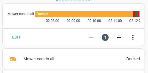

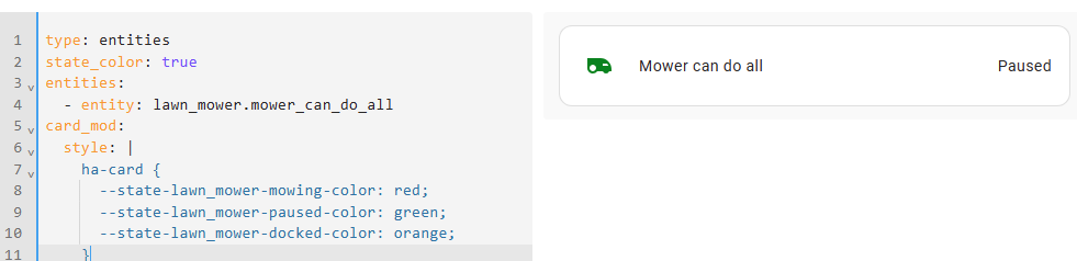

Seems that you anyway made a mistake.
I did myself exactly same what I suggested you:
with a custom theme:
custom:
  state-lawn_mower-mowing-color: red
  state-lawn_mower-paused-color: green
  state-lawn_mower-docked-color: orange
or just with card-mod:
I am honestly not getting why you said that you did exactly the same but failed.
