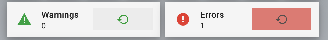

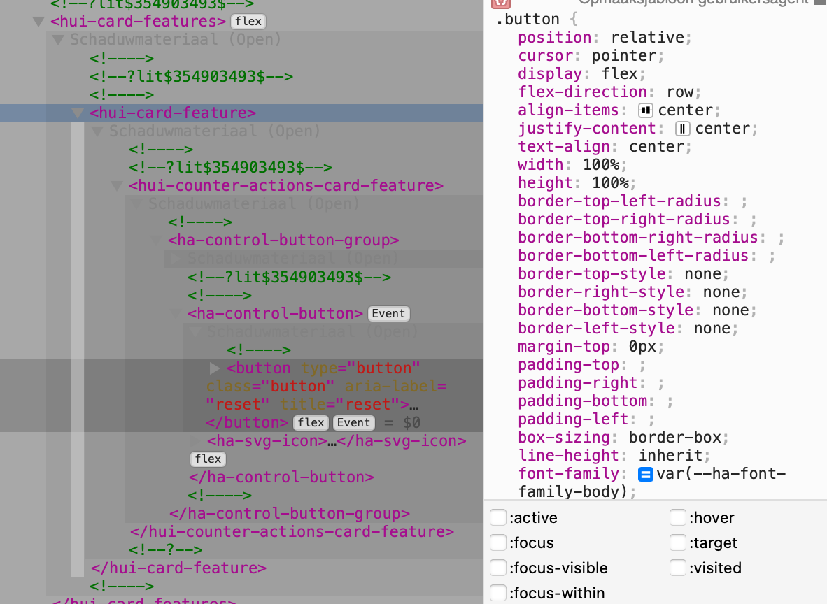

setting 0px to all of my tile card features border-radius’s, I can not find the correct path to the counter button…
according to the Dom inspection it should be
            card_mod:
              style: |
                ha-tile-icon {
                  {% set count = states(config.entity)|float(-5) %}
                  --tile-color:
                    {% if count > 0 %} var(--warning-color)
                    {% else %} var(--success-color)
                    {% endif %};
                hui-card-features $:
                  hui-card-feature $:
                    hui-counter-actions-card-feature $:
                      ha-control-button-group $:
                        ha-control-button $: |
                          .button {
                            --control-button-border-radius: var(--ha-card-border-radius);
                            opacity: 0.8;;
but the button remains rounded:
of course I did try !important, and other css properties, but it just isnt the correct element Ingress.
Could any of you please check?
manually setting there to .button does make it happen
see How to set border-radius on Tile card Features - #8 by Mariusthvdb for the other tiles I managed to set 0px to…

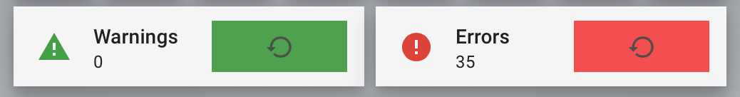

it’s a tile with a counter and a button to reset the counter.
it should be merged correctly now, and the tile-icon bit works fine. still cant set the border-radius though
edit
this does it alright!

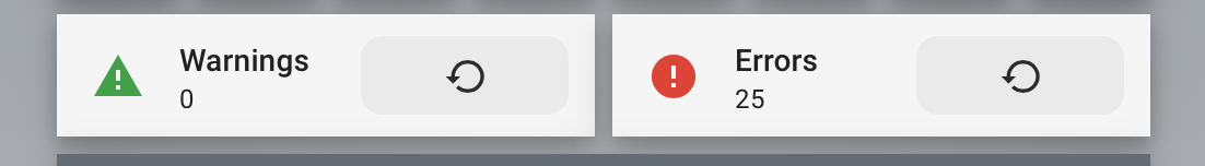

            card_mod:
              style:
                  hui-card-feature $:
                          .button {
                            opacity: 0.8 !important;
                            background: green !important;
                  ha-tile-icon {
                    --tile-color:
                      {% endif %};
the left Warnings is now modded, the right Errors is as is
both modded

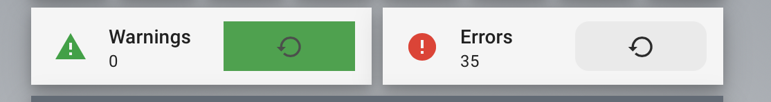

or a bit more subtle with a nice sweet touch to the button icon. well, this suits for now, ill add this to the other thread on Tile features:
            card_mod:
              style:
                  hui-card-feature $:
                          {% set warning = states(config.entity)|float(-5) > 0 %}
                          .button {
                            --control-button-icon-color: {{'green' if not warning}};
                            background: {{'var(--warning-color)' if warning}} !important;
                  ha-tile-icon {
                    --tile-color:
                      {{'var(--warning-color)' if warning else 'var(--success-color)'}};

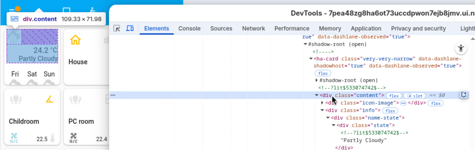

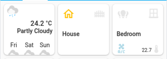

Can anyone help me with the styling of the built-in weather card?
For v2024 I modified styles to change order of temperature and weather state. It made it possible to fill the space on the right side of the weather icon with a bigger temperature, and fit the weather state below.
However, since updated to 2025.5, the weather name ā€˜colides’ withthe weather icon, wrapping the whole right part down.
I’ve already confirmed myself that the length of the text in the weather state causes this behaviour.
Can you help me, what to change in the styles to make the state overlap icon area?

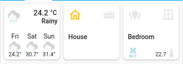

Edit:
I resolved that by setting:
flex-flow: initial; -webkit-flex-flow: initial !important; to .content class does the job

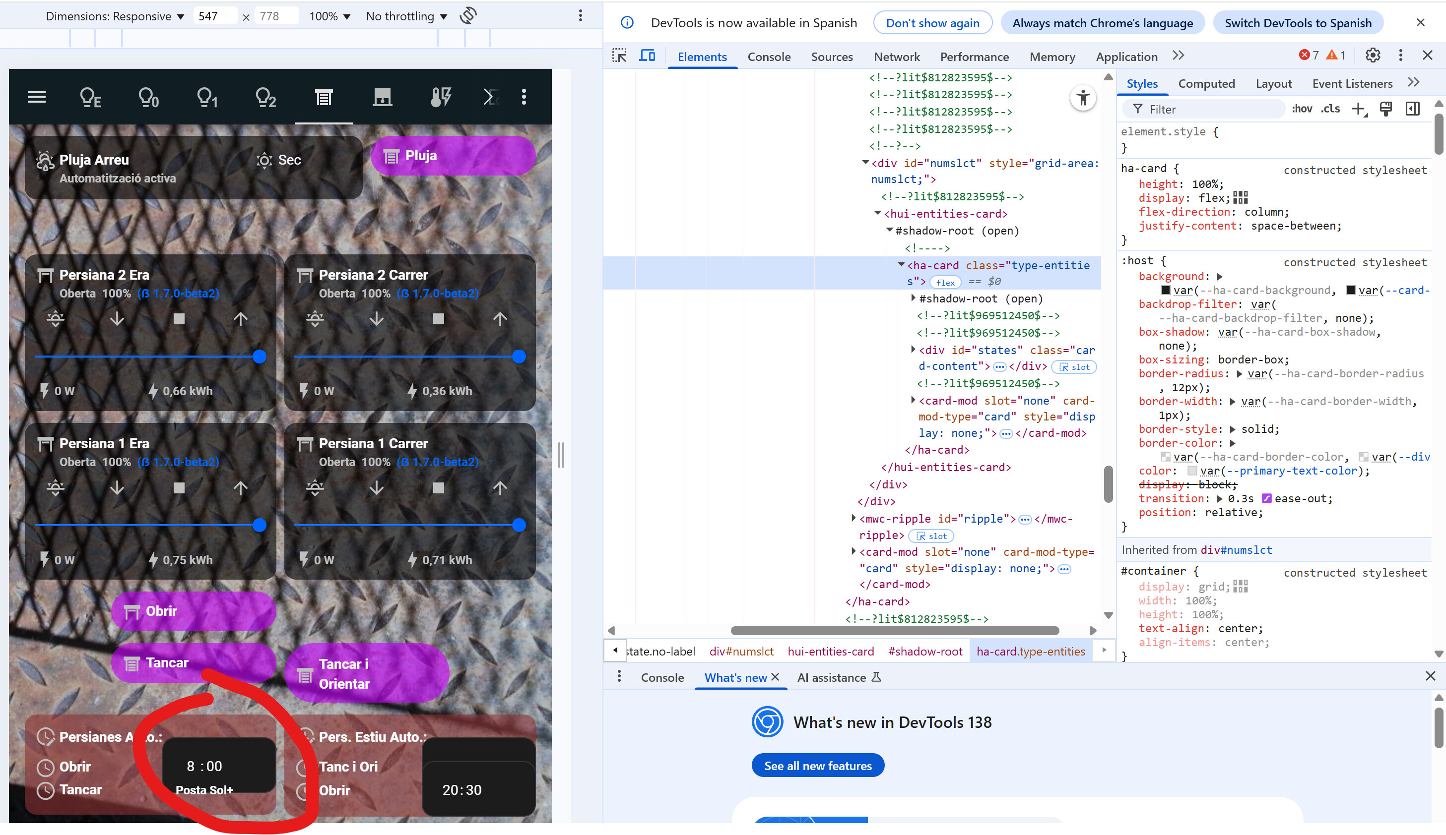

Does anybody know how to change the background and borders in a JS file? I’m attaching the inspector screen capture:
Using card_mod it works well, but the transition is very uggly:
        card_mod:
          style: |
            ha-card {
              box-shadow: none;
              border: none;
              background-color: transparent;
              transition: none !important;
Many thanks!

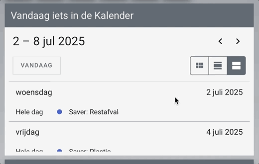

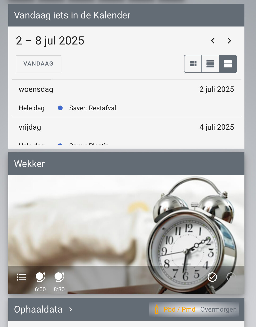

dropping my first use of type: calendar card (and a screenshot of it above a few other cards, to make clear what types of mods I am after, especially the header.)
the card is built so differently from other core cards, it was not too obvious to find the right elements, let alone the right settings for those. the header required a a lot of different manipulation from what I normally do. It also needs the margin set, because it is not the full ha-card width, and a section inside the ha-card, really odd.
And yet here I am, and it’s alright for starters.
My main ask is how to get to the section below the date and buttons for the scroll part. Currently the full calendar scrolls (obviously as that is what I set the scroll to…) but ideally I would love to touch the section below it, so the date remains in view:
      - type: calendar
        card_mod:
          style:
#             ha-full-calendar:
#                 .fc-list-day-text {
#                    font-size: 20px !important;
#                 .fc-list-day-side-text {
              .header {
                background: var(--background-color-off);
                color: var(--text-color-off) !important;
                font-weight: 400 !important;
                padding: 12px !important;
                margin: 0 -8px;
              ha-full-calendar {
                max-height: 250px !important;
                overflow-Y: scroll;
        title: Vandaag iets in de Kalender
        initial_view: listWeek
        visibility:
          - condition: or
            conditions:
              - condition: state
                entity: calendar.afvalwijzer
                state: 'on'
              - condition: state
                entity: calendar.feest
                state: 'on'
        entities:
          - calendar.afvalwijzer
          - calendar.feest
Jul-02-2025 16-53-14
update
think I found it, making vertical space for most 2 events, and deleting all whitespace below that:

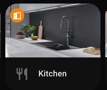

With the new Area Cards introduced in 2025.7, anyone know how to remove the mdi icon?
you can probably use the same card_mod as for the tile cards
did you already try that?
