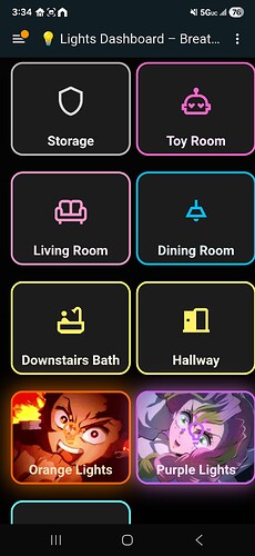

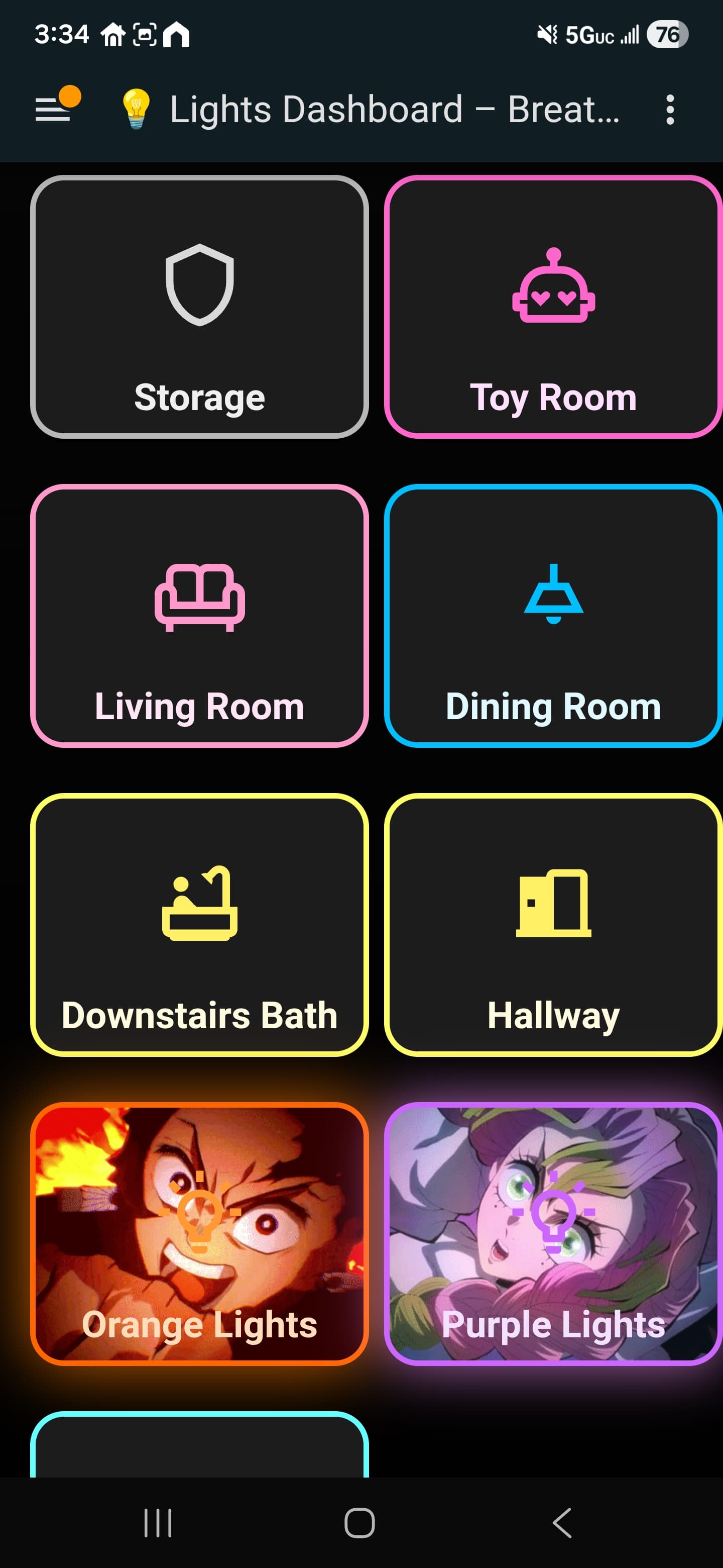

I created gif buttons using card-mod.

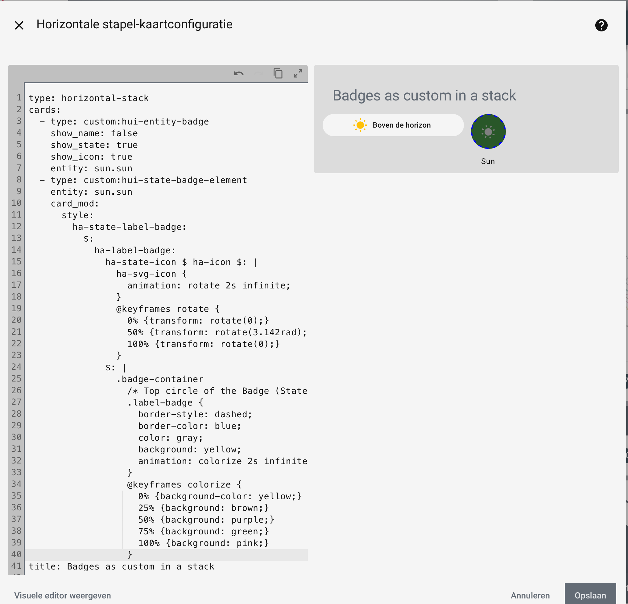

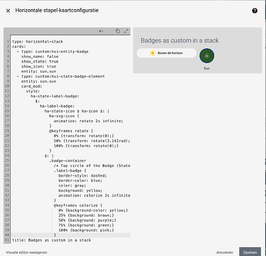

so do you say the card-mod modifications we can do back again now on the top view type: custom:hui-state-badge-element is blocked in the custom:badge-card but not in this custom:badge-horizontal-container-card ?
ok now find a mod to move stuff :wink:
… wraps each badge in <hui-badge> just like Frontend.
… does not.
YAML (Browser Mod test stuff removed)
type: custom:badge-horizontal-container-card
badges:
  - type: custom:hui-state-badge-element
    entity: sun.sun
    card_mod:
      style:
        ha-state-label-badge:
            ha-label-badge:
              ha-state-icon $ ha-icon $: |
                ha-svg-icon {
                  animation: rotate 2s infinite;
                @keyframes rotate {
                  0% {transform: rotate(0);}
                  50% {transform: rotate(3.142rad);}
                  100% {transform: rotate(0);}
                .badge-container
                  /* Top circle of the Badge (State) */
                  .label-badge {
                    border-style: dashed;
                    border-color: blue;
                    color: gray;
                    background: yellow;
                    animation: colorize 2s infinite;
                  @keyframes colorize {
                    0% {background-color: yellow;}
                    25% {background: brown;}
                    50% {background: purple;}
                    75% {background: green;}
                    100% {background: pink;}
badges_align: center
badges_wrap: wrap

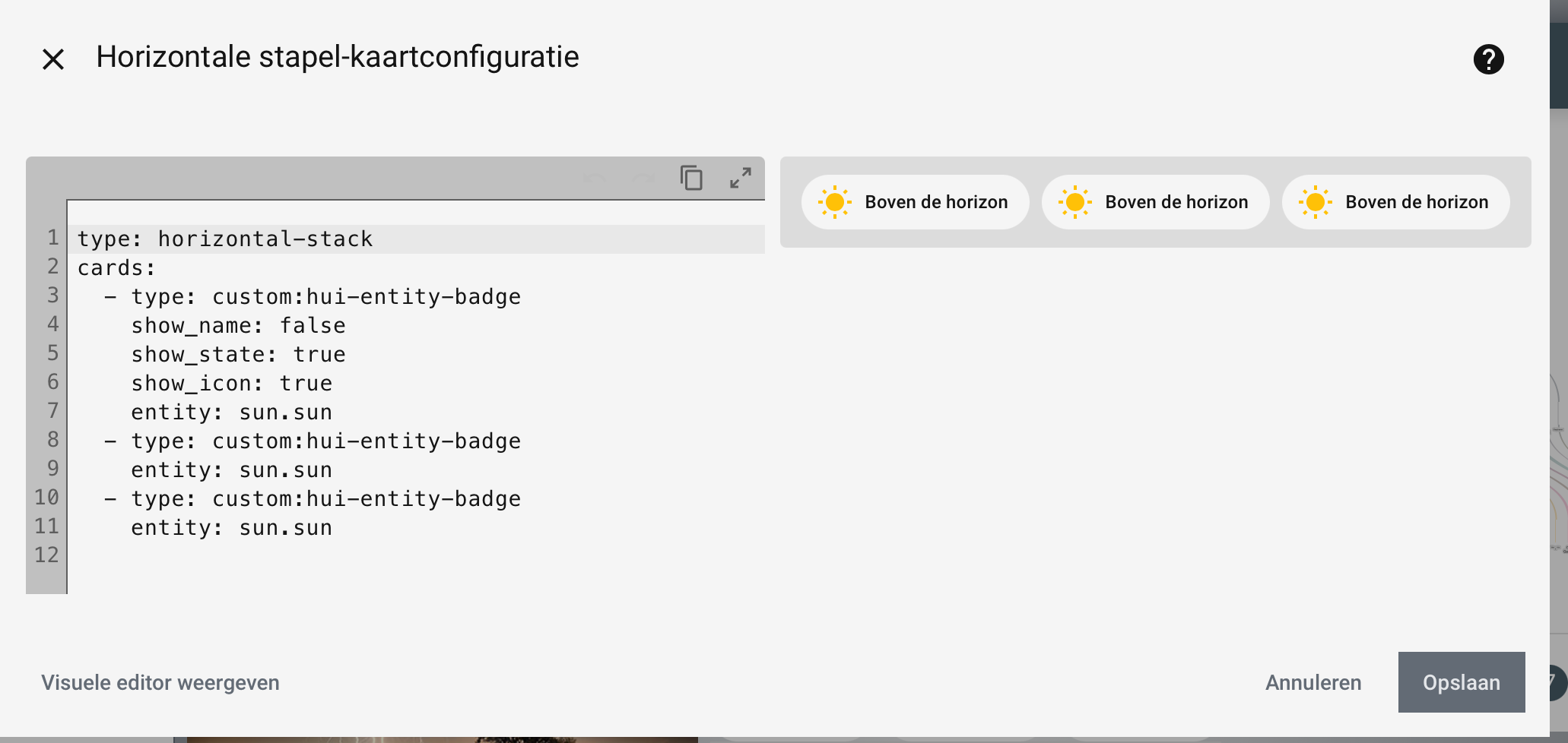

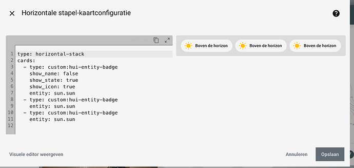

yes we can:
type: horizontal-stack
cards:
  - type: custom:hui-entity-badge
    entity: sun.sun
    entity: sun.sun
    entity: sun.sun
though we need some setting (card-mod… ? ) to not have a single badge use the full width there…

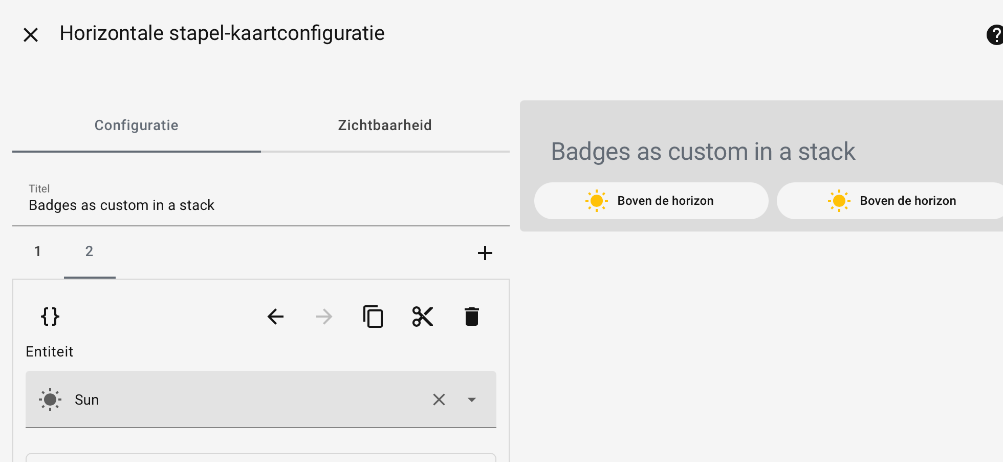

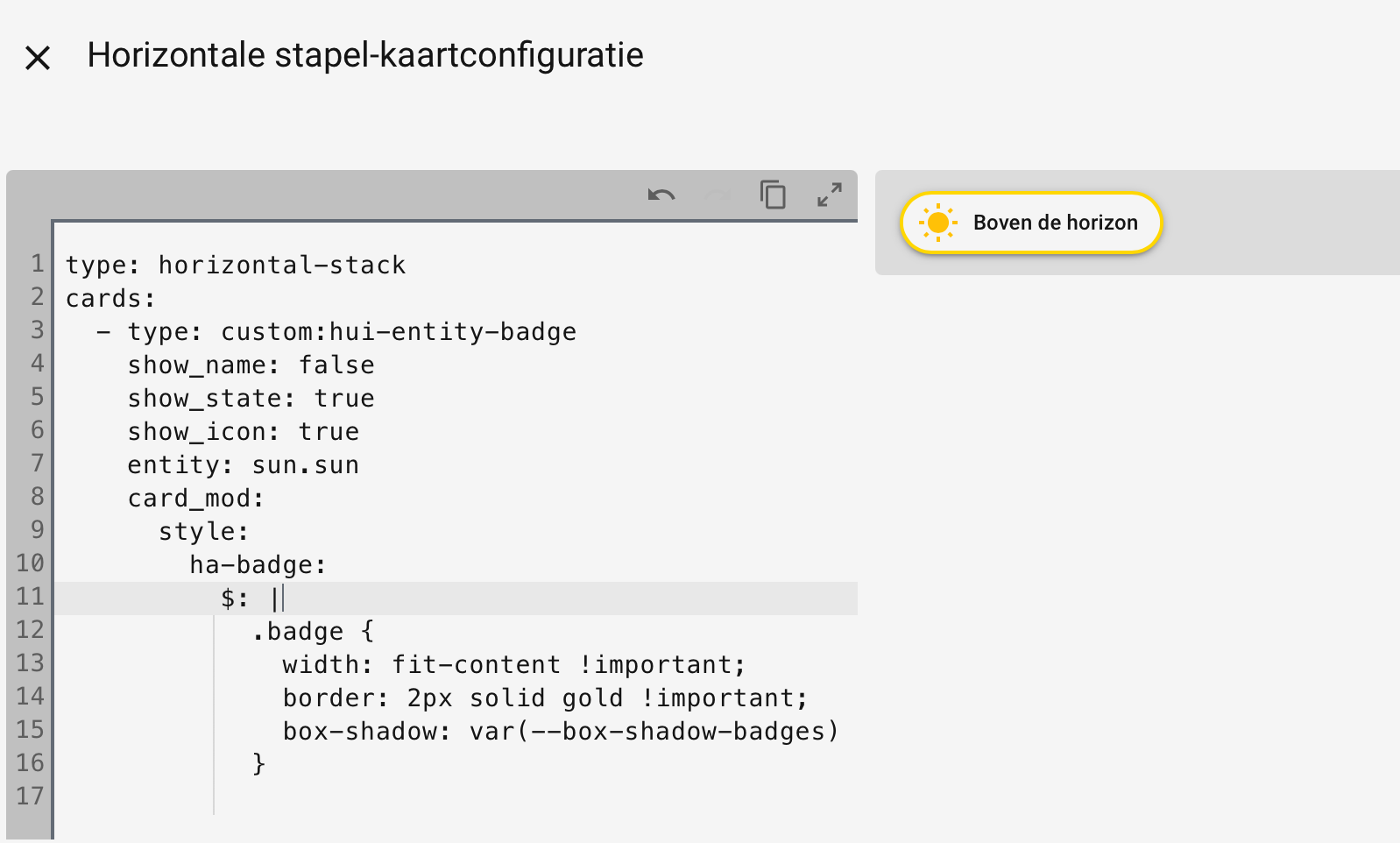

that card_mod styling to get the badges to fit content is rather straightforward …
cards:
    show_name: false
    show_state: true
    show_icon: true
    entity: sun.sun
    card_mod:
      style:
        ha-badge:
            .badge {
              width: fit-content !important;
              border: 2px solid gold !important;
              box-shadow: var(--box-shadow-badges) !important;
which means we can drop any badge anywhere now. just add this 1 card_mod yeey
