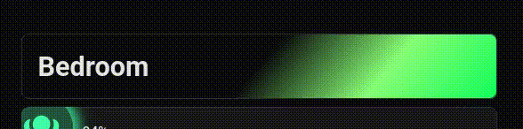

What would I look at to make the color change smoother? Right now, it’s kind of janky as it jumps between colors.
Linear gradients are janky, so you need to add more stops
Like I said above, I’m actually happy with the linear gradient on a static scene - the area is small enough that the kind of jank that the blog author discusses isn’t really an issue. It’s when I switch colors on the bulbs that the card can’t decide what to do so it flips between two states until it settles and that can look SUPER janky when it’s dramatic differences between scenes or long transition times (>10sec).
@fusterclucker do you have a simple example config to show what you are describing?
I don’t. card-mod is the first time I’ve looked at CSS in 20 years - it’s gotten a fair bit more complicated.
EDIT: I was able to capture a short recording of this. These are 5 second transitions via the dashboard buttons I have for the scenes - I have tried longer, and the hesitation for the transition is greater but the initial ā€œlurchā€ towards the end result is the same.
janky_gradient_button_1
If I am understanding you correctly, its scene transition that is giving you ā€˜jankiness’. So I would assume that your template is getting some quick updates due to this, hence what you see as changes in the output.
To assist in seeing what is going on, you can add {# card_mod.debug #} to your template and you will see console logs when the template updates, and what the result is.
