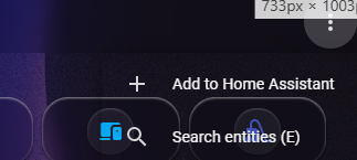

I am trying to add backdrop filter and set background to the .mdc-menu-surface dropdown element across ha. I have just tryied to apply the style in dev tools and getting weird results:
I have in my theme set the header to be transparent:

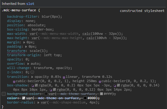

And when I remove color and background in the devtools from the .mdc-menu-surface it becomes transparent and when I add backdrop-filter, nothing happens:

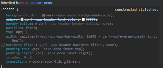

But when I remove the backdrop-filter from .header:

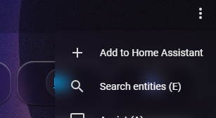

It applies the backdrop-filter to the .mdc-menu-surface:
But I would like to have both, the header and the dropdown with backdrop filter.
Just a heads up…This is the correct thread for card-mod themes inquires
Check out https://stackoverflow.com/questions/60997948/backdrop-filter-not-working-for-nested-elements-in-chrome.

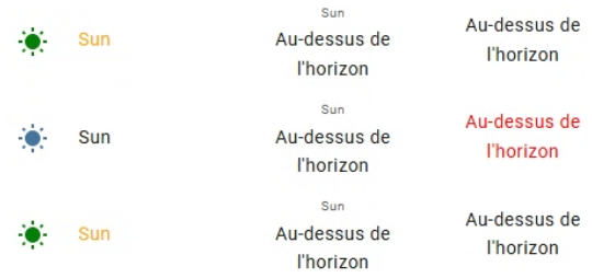

In a “custom:multiple-entity-row” I want to:
A. change the color of the left icon (green)
B. change the color of the left text “name” (orange)
C. change the color of the right texte “state” (red)
I found in this topic each solution (thanks to Ildar_Gabdullin), I could combine 2 of them but not the last one. How can write the code to get all colors inside the same line?
Is there a way to “guess” which “keyword” (state-badge, .info, .state-entity, hui-generic-entity-row, …) I need to use.
Here is my code, the first entity is request A and B, the second entity is request C , the third entity is what I tried but it don’t work.

Away from a PC, typing from a mobile, try this:
    card_mod:
      style:
        hui-generic-entity-row:
            state-badge {
              color: green !important;
            .info {
              color: orange;
            .state.entity ….
But actually you should have found out the solution by yourself. See, the main icon-related part is in shadiwroot ($), other stuff - not. Now you need to combine two parts - shadowroot-part and “normal” part. Check “fantastic post - other stuff - how to combine” for explanation.
Thank you very much, it works :slightly_smiling_face:. I need to read all the documentation again, for the moment I still don’t understand all the levels, and what is at which level :sweat_smile:.
Thanks again for your help and for all the documentation you made!
