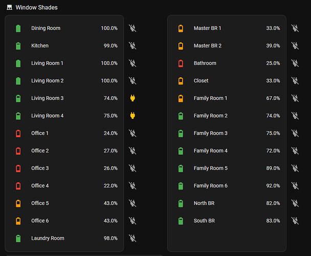

I can’t figure out icon colors. I want the plugged-in icon gray when unplugged and yellow when connected.
Here’s my current setup:
Main card:
type: entities
entities:
  - entity: sensor.dining_room_shade_battery_level
  - entity: sensor.kitchen_shade_battery_level
  - entity: sensor.lr1_battery_level
    name: Living Room 1
  - entity: sensor.lr2_battery_level
    name: Living Room 2
  - entity: sensor.lr3_battery_level
    name: Living Room 3
  - entity: sensor.lr4_battery_level
    name: Living Room 4
  - entity: sensor.office_1_battery_level
  - entity: sensor.office_2_battery_level
  - entity: sensor.office_3_battery_level
  - entity: sensor.office_4_battery_level
  - entity: sensor.office_5_battery_level
  - entity: sensor.office_6_battery_level
  - entity: sensor.laundry_shade_battery_level
state_color: true
layout_options:
  grid_columns: 3
  grid_rows: auto

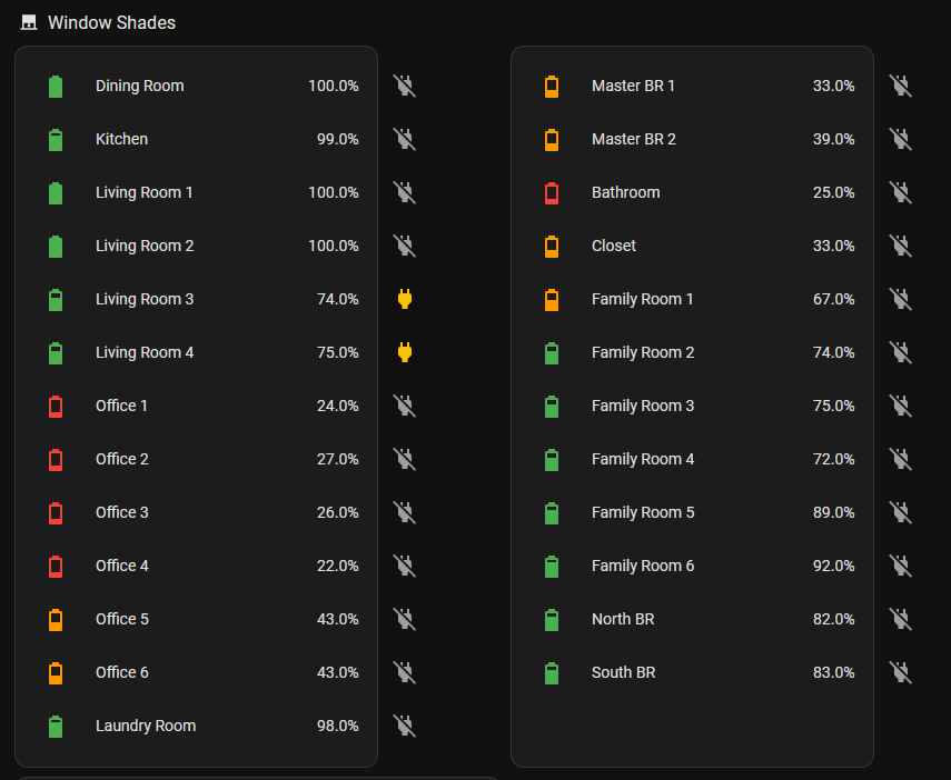

Here’s what I want but I can’t figure out how to change the icon colors:

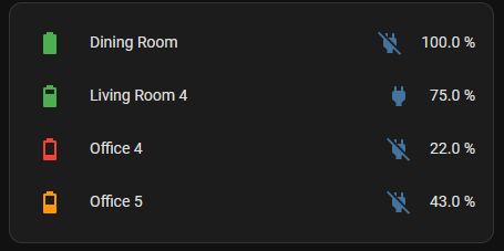

Try this inside multi-entity-row
add
state_color: true ( On the entity ) under entities
then in line with
entities:
card-mod
style:
  hui-generic-entity-row:
      div.entity:nth-child(1) state-badge {
        color: grey;
And skip the whole cumbersome :host style (on the Entity)
Thanks, but that didn’t apply any color.
The bit using :host is to toggle the active/inactive color of the ac_mains_re_connected icon. That’s what worked in the ā€œPlug status cardā€ in my original setup, but doesn’t have any effect in multipe-entity-row.
I have no idea what your talking about, the code i suggested works fine in my multiple-entity-row
with both switches(plugs) and binary-sensors etc inside
