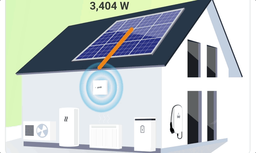

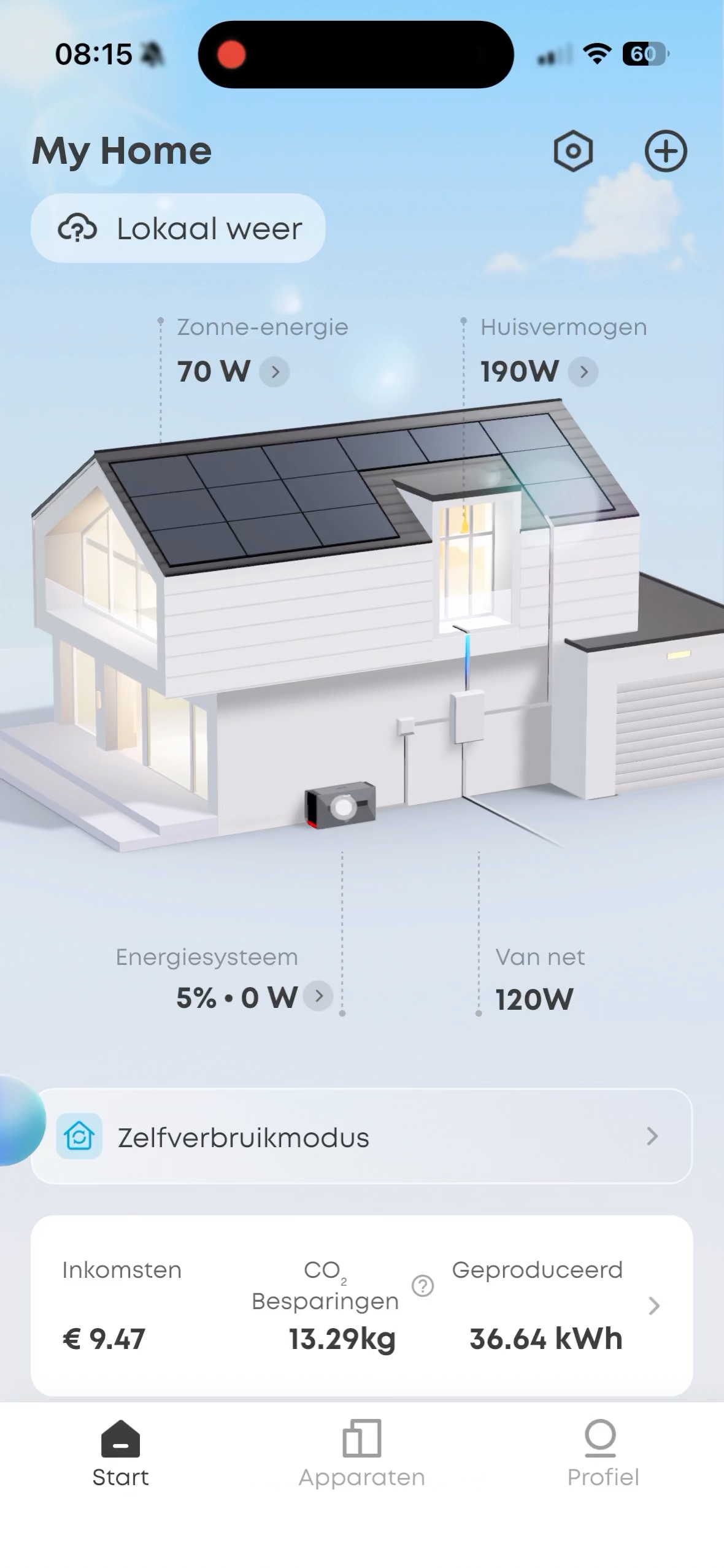

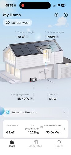

Dear Home Assistant friends, I’ve been trying for a while to set up energy flows—specifically, the yellow flow running from the solar panels to the inverter.
However, I just can’t seem to get these flows to display over the background image of my house.
I’d really appreciate some help; what am I doing wrong? Or perhaps someone has an example of a working energy flow setup that I could use as a starting point?

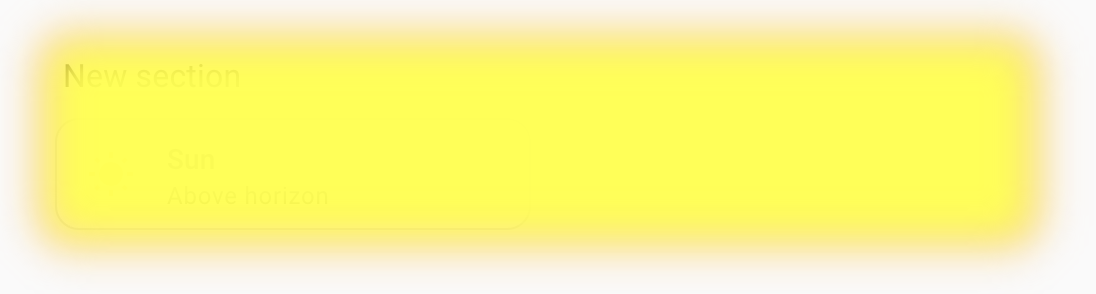

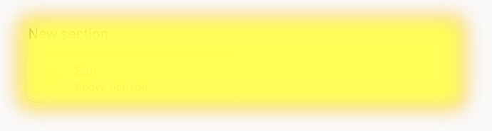

Hi all!
Absolutely stumped on two things… I can’t write a line of card mod or UIX after styles: | and apparently AI isn’t much good at DOM navigation, so I turn to you for help :joy: Any assistance is much appreciated!
I don’t mind if UIX or Card Mod is the solution. I use UIX which supports both tags.
1: Blurring an entire section (guest mode)
I would have thought it would be relatively easy to enable the native section bg, move it to the front, and add a backdrop-blur. After many attempts with AI, I conclude it is not easy. At all.
I just want an entire section of a Sections view to be blurred over in accordance to these conditions. Ideally able to adjust blur amount + opacity + border radius.
{% set is_admin = user in ['e91501a8d72f4c3a8f2fa2e9a63659a6', '03e2ff1c5d1241418a77c2609aa9087b', 'e09a62a480d741309a61316b521c72a8'] %}
{% set guest_mode = is_state('input_boolean.guest_mode_dashboards', 'on') %}
{% if guest_mode and not is_admin %}
2: Getting rid of the new blur on heading cards (is it an issue with my theme, do others have backgrounds on their heading cards as of 2026.8?)
I can do it alright with card mod within the card, but I’m looking to put it in a theme so I don’t have to do it a million times. It doesn’t work.
Now:
Before:
Working code per card:
card_mod:
  style: |
    ha-card {
      --ha-card-background: none;
      backdrop-filter: none !important;
      -webkit-backdrop-filter: none !important;
Again, thank you :slight_smile:
UIX has section background support which extends the usual background.
This example is Option 2, no templates which I you can manage yourself.
You need to edit the section in yaml mode for this. Three dots at the top when editing section in UI.
type: grid
cards:
  - type: heading
    heading: New section
  - type: tile
    entity: sun.sun
    vertical: false
    features_position: bottom
background:
  uix:
    style: |
      :host {
        --ha-section-background-color: yellow;
        border: 2px solid red;
        z-index: 1 !important;
        filter: blur(10px);
        opacity: 0.98 !important;
Use UIX theme and host element/path selector with class type (added by UIX) is a good way. You can even be more fine grained with the other path selectors including attributes and even properties (think card config as a property - style based on what the heading text is :wink: )
  uix-card-yaml: |
    "&.type-heading": |
      ha-card {
        background: red;
Screenshot 2026-08-15 at 6.55.57 pm
Thank you so much :folded_hands: I spent an hour trying to do those yesterday. Never thought to look at UIX docs :joy:
Sorry for all the post edits. I kept having issues and solving them. Here’s what I’ve ended up with in a UIX theme.

Thanks for your help. In the video, you can see blue and yellow energy lines running from the solar panels to the inverter and from the inverter to the house. I want to see those in my dashboard background as well.
What I meant was a simple yaml code example. Your config is way too complex to replicate for reviewing.
I’ve shortened the code so that only one energy flow should be visible; hopefully, this makes things clearer.

Thanks. Enough to see what you are trying to do. A button-card will never work as a custom picture element. They are tricky as I know when adding the mold: badge_as_picture_element cross context mold to UIX Forge. You will note there is no other ..._as_picture_element cross context molds.
Saying that, UIX Forge mold: badge_as_picture_element can get you a solution.
  1. You will need a badge that can easily give you a line to play with. I have used custom:entity-progress-badge as a quick example of what is possible. That card looks to have some great built in features. If you just want a 100% line to play with, set any entity and then override --progress-bar-value to 1 !important. The custom card itself has a shimmer that you can look at to either tweak for speed or add your own styling with UIX
  2. Then play with styling with UIX. I have done a simple z transform to rotate. Note: As this is UIX Forge all your element config can take templates.
See my example. Since I did not have your house I found some picture out there to just mock up an example. You look to know your way around so I will leave this idea with you as an alternate. I think in the end will be simpler. Play with whatever badge in UI then copy code into the Forge.
It would not take much to write your own custom badge to use in this way (there are no such thing as custom picture elements so you need to use UIX Fogre to place a custom badge).
type: picture-elements
image: /local/media/house.png
elements:
  - type: state-label
    entity: sensor.sim_power_solar
    style:
      top: 9%
      left: 42.5%
      transform: translate(-50%, -50%)
      color: '#3c3c3c'
      font-size: 22px
      font-weight: bold
  - type: custom:uix-forge
    forge:
    element:
      type: custom:entity-progress-badge
      entity: light.bed_light
      bar_effect:
        - shimmer
      bar_stack: {}
      hide:
        - icon
        - name
        - value
      style:
        top: 35%
        left: 45%
      uix:
        style: |
          ha-card {
            --ha-card-background: transparent;
            --ha-card-border-width: 0px;
            transform-origin: center;
            transform: rotateZ(130deg);
            --progress-bar-value: 1 !important;
Aug-16-2026 21-25-54

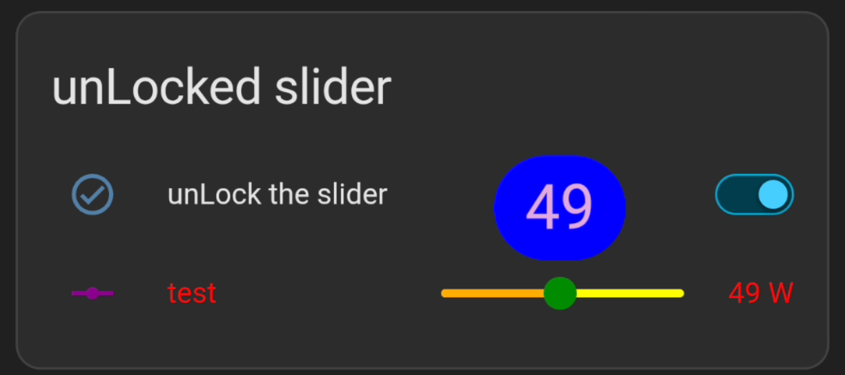

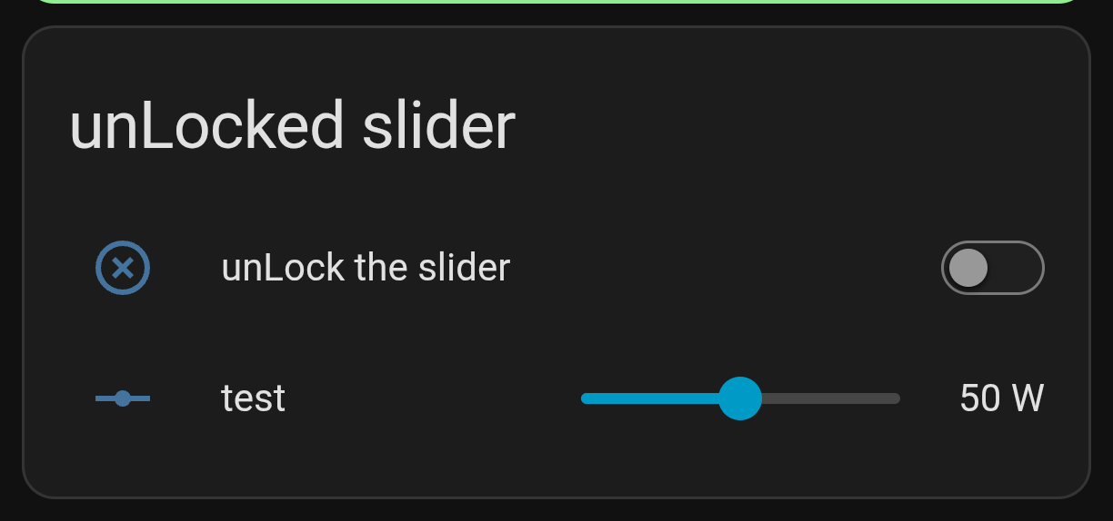

Colored (unLocked) slider:
type: entities
title: unLocked slider
entities:
  - entity: input_boolean.test
    name: unLock the slider
  - entity: input_number.test
    tap_action:
      action: none
    card_mod:
      style: |
        :host {
          {% if is_state('input_boolean.test','on') %}
            --ha-slider-track-color: yellow;
            --ha-slider-thumb-color: green;
            --ha-tooltip-text-color: plum;
            --ha-slider-indicator-color: orange;
            --state-icon-color: purple;
            --ha-tooltip-background-color: blue;
            --ha-tooltip-font-size: 30px;
            --ha-tooltip-border-radius: 30px;
            color: red;
            pointer-events: ;
          {%else %}
            pointer-events: none;
          {% endif %}
