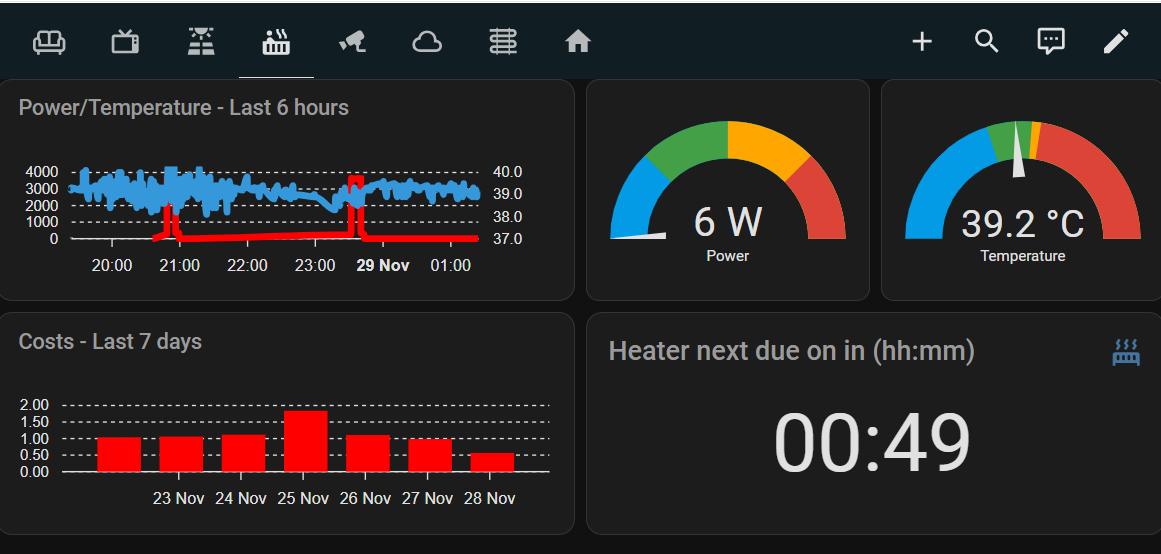

Anyway, I have an Entity card displaying in the bottom right of a particular dashboard view (pictured). I would like to change the colour and size of the icon. Googling hasn’t revealed the answer!

The whole screen is in the picture.
You can use CSS vars in ha-card{ }. You may also wish to add align-items: center to .header if you wish the header text to be aligned center vertically if you are increasing the size of the icon.

Thanks, that worked.
I tried the align-items: center; thing but that didn’t do anything! But I’m happy with the way it looks now.
