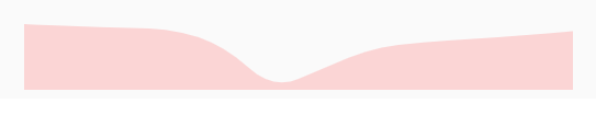

When rendered, I get what I want (picture below). Card mod is used to remove the white background (now is transparent) and to remove the border radius.

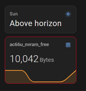

This is not about card-mod, this is about particular styles:
type: custom:layout-card
layout_type: custom:grid-layout
layout:
  grid-template-columns: repeat(auto-fill, min(260px))
cards:
  - type: entity
    entity: sun.sun
  - type: custom:mini-graph-card
    entities:
      - entity: sensor.ac66u_nvram_free
    card_mod:
      style: |
        ha-card {border: 1px solid red;}
Use Code Inspector to select proper attributes.

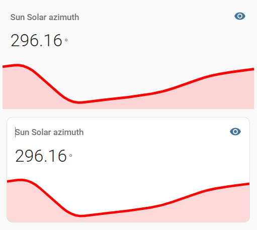

I think I must disagree. Why it works if the element is not part of the grid and not if it is part of the grid?
type: vertical-stack
cards:
    entities:
      - entity: sensor.sun_solar_azimuth
        color: red
    card_mod:
      style: |
        ha-card {border-style: none; background: none; border-radius: 0;}
  - type: custom:layout-card
    layout:
      overflow-y: auto
    cards:
        entities:
            color: red
        card_mod:
          style: |

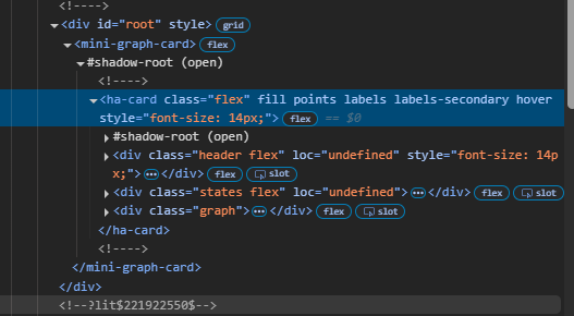

This is in the inspector for the top graph on the picture above:
The mini graph ha-card and the card-mod cards are in the same level for the top graph on the picture above.
While there is no card-mod part for the bottom graph:

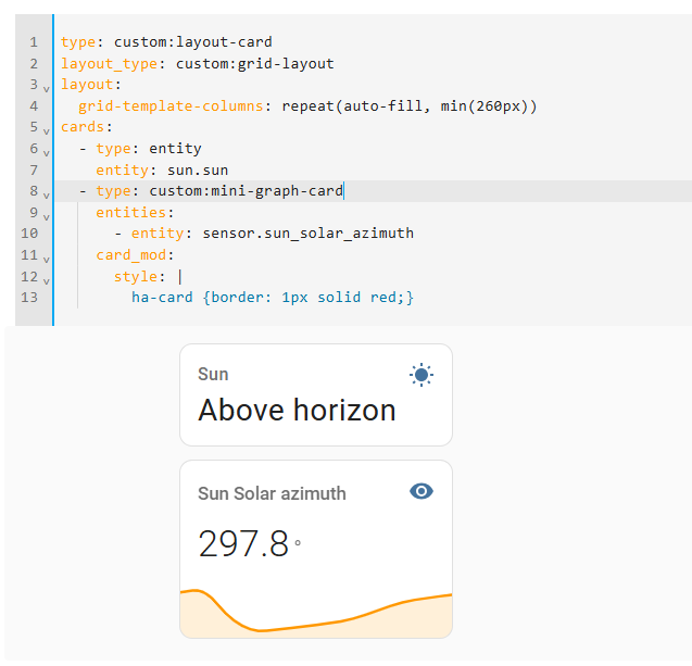

Even if I replicate your demo:
layout:
cards:
  - type: entity
    entity: sun.sun
    entities:
    card_mod:
      style: |
I don’t get red border:

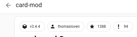

Check if you have card-mod 3.4.4 (the LATEST one) installed
Here is the trick. Thanks. Works now. I was under impression HA will offer an update if there is a new release.
I wonder if you were running 3.5.0 ?)
HACS usually gives notifications about new versions.
If you are installing 3rd party plugins manually - it is only up to you to monitor updates.
Yes it was 3.5.0. Before my redownload, it said 3.5.0 on the icon where you see 3.4.4 below:
Might be I pressed update some time ago without noticing.
In this particular case it was not your fault, 3.5.0 was the latest and you obviously wanted to download it. But this version was cancelled a few days after its release.
