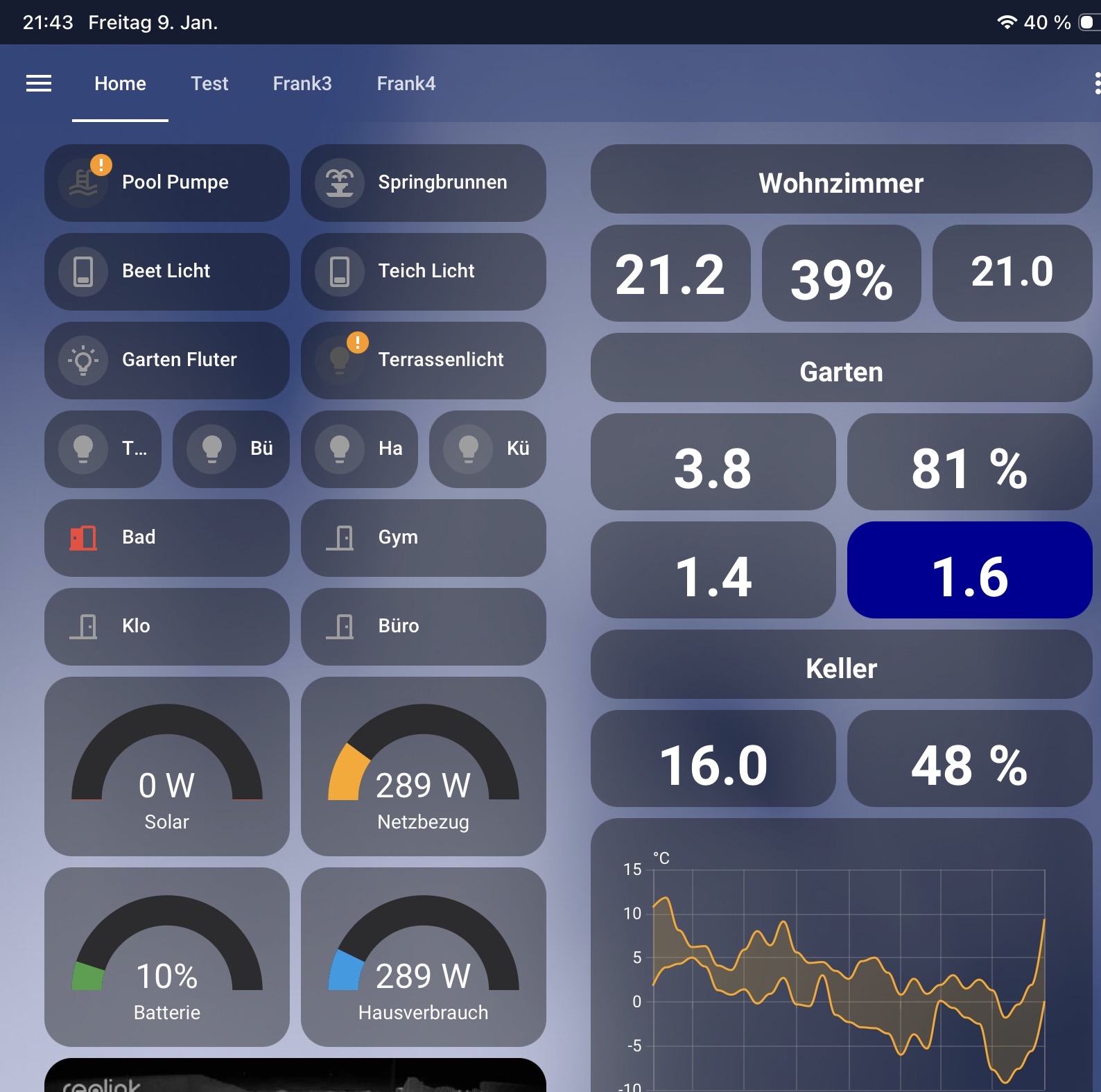

Hello, after installation of 2025.05 my cards changes size.
If you look at the picture you will see the size height of the cards increased, and the text, run out of the box. Like Garten, and 14.4
  1. is this a known bug and it will be changed again, or
  2. Do I have to change something in my css as it will stay this way.
    3.I allready tryed to solve the issue with margin and padding, but my knowledge is not sufficient, as my programming stopped with Shell.

Hello Frank65,
My guess is this is your problem, The first one in this section.
These are not card-mod changes in 2025.5.
Same may be replicated without card-mod, just specify titles in horizontal stacks.
Old issue registered in GitHub.
I’ve noticed the same problem with default hui-button-card. They seem to have added a margin above the text, which makes my buttons all larger and breaks my layout. I can fix it, per button, with card-mod, but for now I’ve reverted to 2025.4.2 to see if they fix it properly. Surely wasted space is a waste of space :slight_smile:

For me the option in the layout grid card that controls the padding made the card correct again. Change it to 0px
