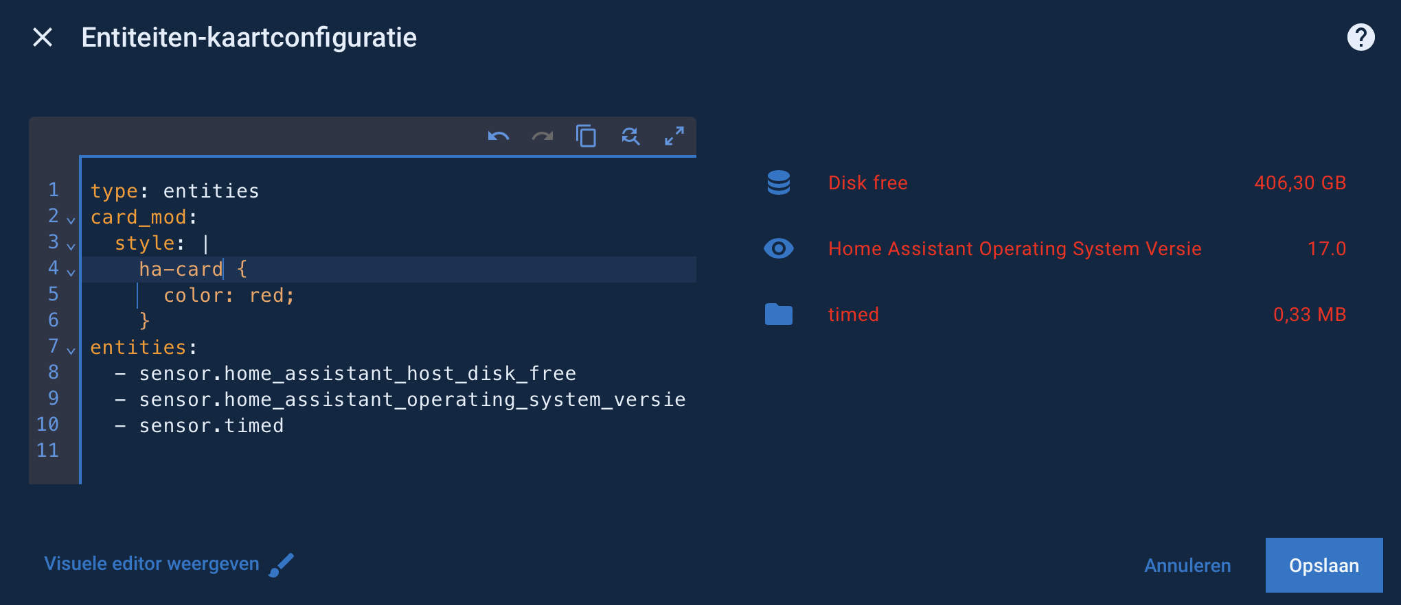

I’m not a frontend guy, but I’m pretty sure entity cards do not accept templates.
Replace “:host” with “ha-card”.
More card-mod examples: main card-mod thread - 1st post - link at the bottom named “fantastic”.
This is card-mod, it supports jinja.

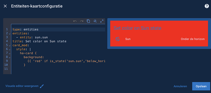

not exactly sure what you’re after, but this is what happens if you set the color on the card, is that your goal?
(I’ve not added a template yet, which is easy and only a matter of replacing there. first you make sure to get the right target in the card_mod, and also result :wink: )
I mean, you’ve got to realize youre setting the mod to the card as a whole, and not the individual entities.
like this card’s background
type: entities
entities:
  - entity: sun.sun
title: Set color on Sun state
card_mod:
  style: |
    ha-card {
      background:
        {{ 'red' if is_state('sun.sun','below_horizon') else 'orange'}};
