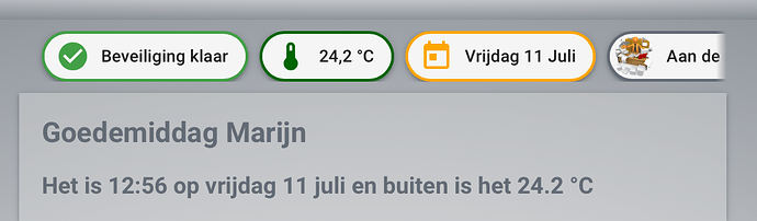

which adjusts the gap within the Header between the markdown card and badges I use. Also this softens the mask-image a bit, as it is too fuzzy for me in HA default theme.

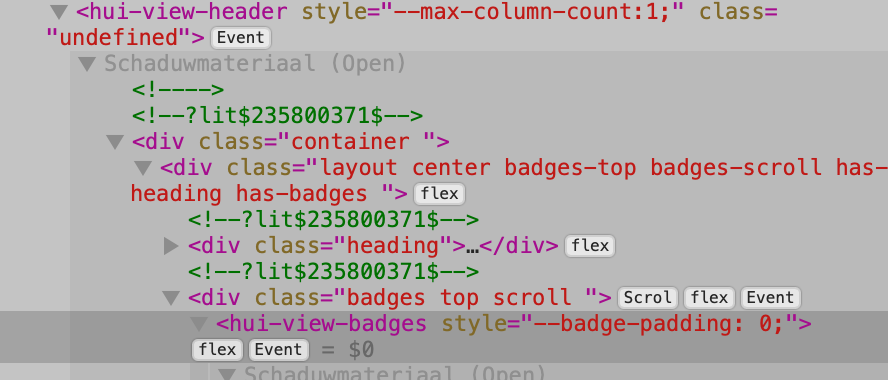

I now want to also remove the badge-padding from the hui-view-header (I just dont like all of that padding in the modern HA frontend), which I can do in Inspector:
I am really sorry, but can not find the correct element… before (see also somewhere above) we could do this:

I want to get to:
in stead of the current

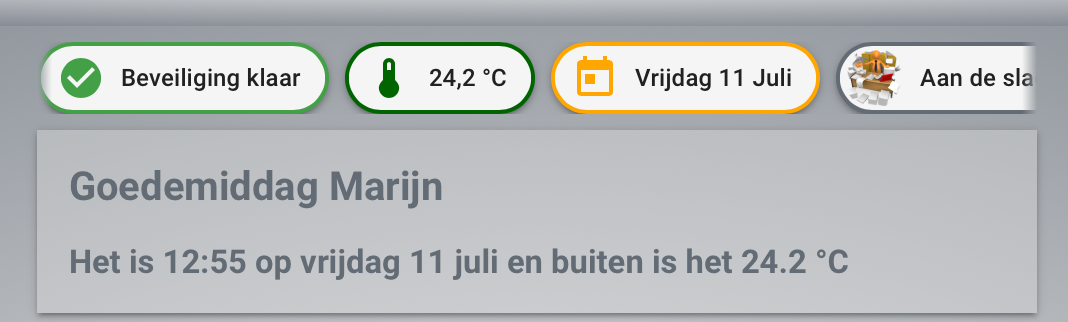

update
cheking the source for that styling
shows what to do:
  card-mod-view-yaml: |
    :first-child $:
      hui-view-header:
          .layout {
            gap: 8px !important;
            --spacing: 8px !important;
          .badges.scroll {
            mask-image: linear-gradient(
                90deg,
                transparent 0%,
                black 1.5%,
                black 98.5%,
                transparent 100%
              ) !important;
          .badges-scroll hui-view-badges {
            --badge-padding: 0px !important;

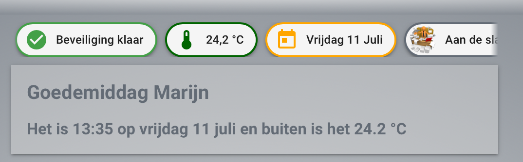

can even play around with that some more, to make it just touch the mask-image:
            --badge-padding: 4px !important;
and get:

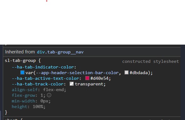

I would like to change the selectionbar icon color while selected.
When I changed --ha-tab-active-text-color in developer tools, it worked, nonetheless I am not able identify the right format and place in card-mod-root-yaml in theme to have it working.
CSS magicians any advice pls?
check my gist at card-mod-themes · GitHub
unfortunately we need to use the theme variable --sl-color-primary-600
I did FR to change that, but no response so far
update
we can now use --ha-tab-active-text-color in 2025.10. also note I had to add the height, because of the dynamic icon-size

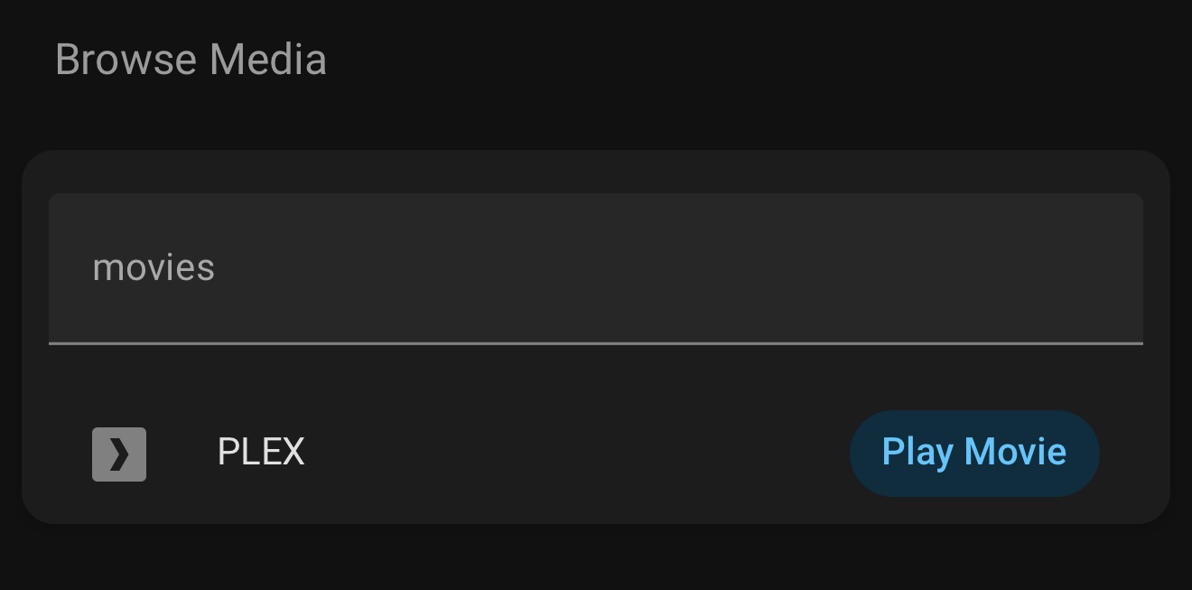

The play action button in an entities card has a blue background ever since I upgraded to 2025.9. Can someone tell me how to remove it? Can’t figure it out in card mod
type: entities
    entities:
      - type: call-service
        icon: mdi:plex
        action_name: Play Movie
        service: script.plex_stream_alayna_2
    card_mod:
      style: |
        ha-card {
        --card-mod-icon-color: grey;
        --card-mod-button: grey;
        padding: 0px 10px 0px 0px;
        margin: -30px 0px -10px 0px;
        :host {
          color: red;
          --mdc-theme-primary: gray;
