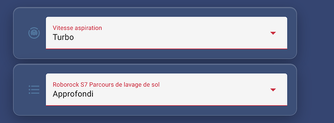

I want to change the color of all the things in red …
I didn’t find anything about it . The for your help.

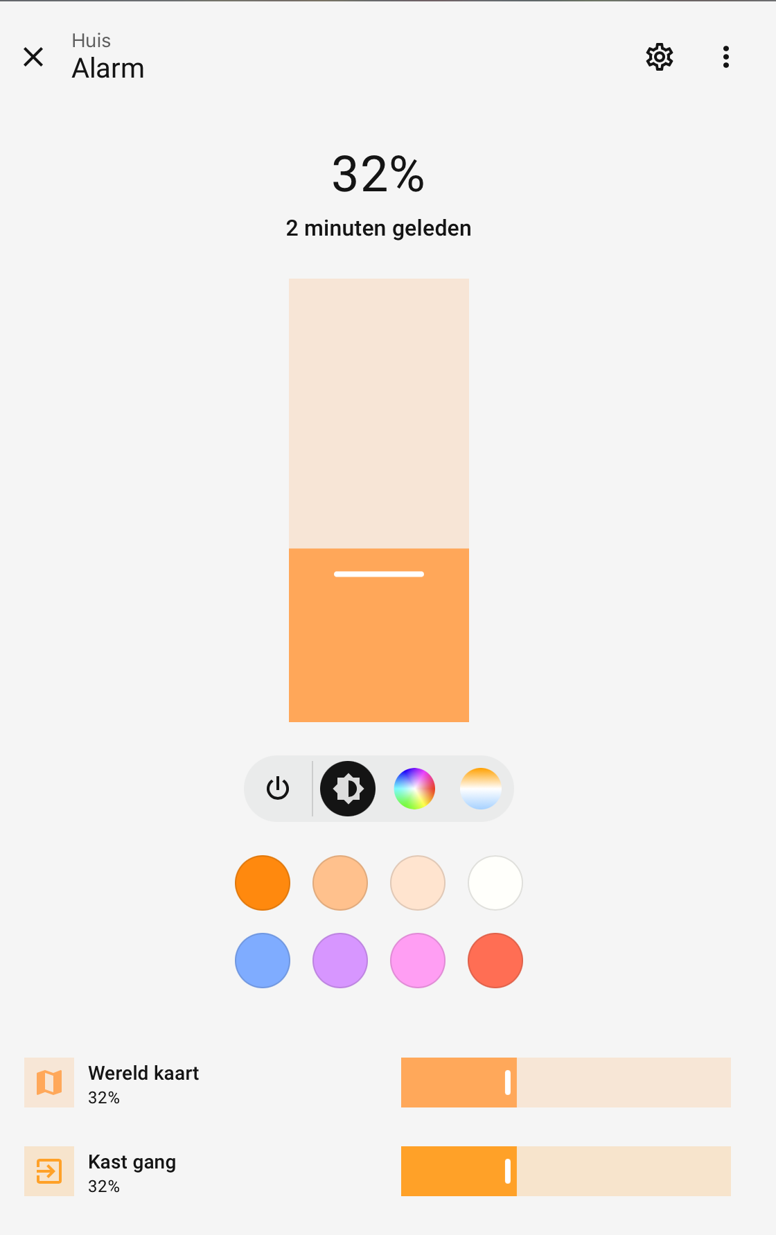

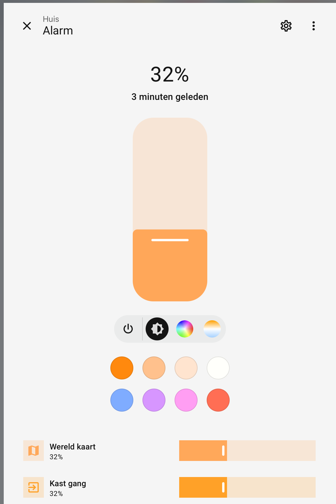

believe it or not, but I have never tried to set a border-radius on the more-info touch elements, like the slider or toggle
ever since these were made a lot wider than before, my eyes clash on the sheer size of them, and the rounded corners look even less attractive in my ā€˜squared’ themes.
If I set those radius’s in inspector, it changes to
which suits the underlying group members much better, now they are also styles with the ha-card-features-border-radius
we’re talking about the .slider and the .slider-track-bar set to 0px. has anyone tried that successfully?
if so please share? I do so hope this can be made into a generic more-info-feature class…
