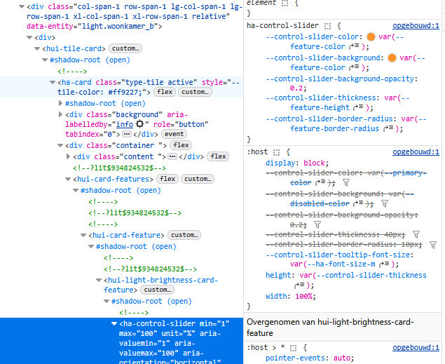

How can i change the slider height to 20 px for all hui-tile-cards in my theme.
This is what inspector shows me. The height is in control-slider-thickness defined in variable --feature-height
