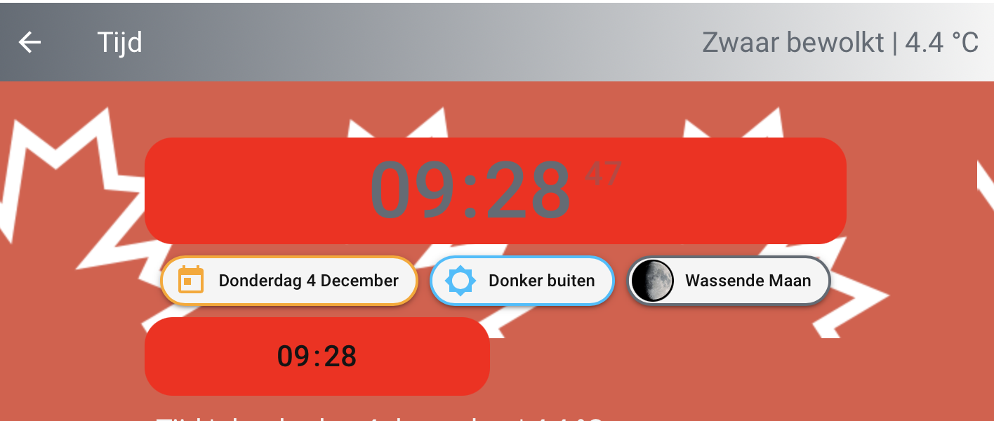

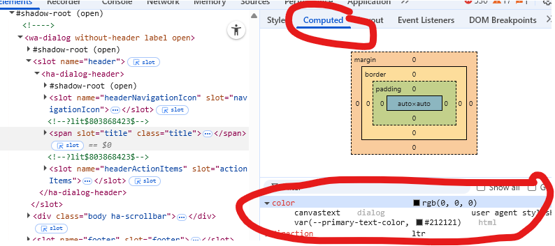

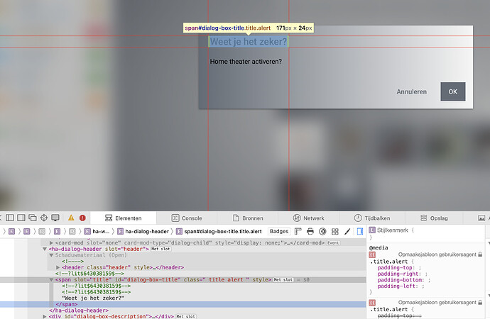

It is not doing anything here. It would with the mod above from Darryn, but without as general variable, it is not here.
And I would wonder if it would, because it is not used in the dom at any place for this title here. Are you on any beta version of HA in this test? I’m testing on 11.3
yes I am running 2025.12.0b8 now
(note if you get borders on your markdown, use the same var I set above, borders were added by default in 2025.12) see 2025.12 Markdown changes, and how to mitigate
Can you show the dom part of that title, where the variable is used/assigned, so that I can compare?
I’m lost. As said, the variable is not used for this title here. It is fixed black. Whyever.
I dont know why it was changed, there were a lot of changes, and many had to be reverted, because of untested/unforeseen complications.
if you’d test run this beta, you could give that as feedback before the beta is moved to release tonight.
there is still time
and no I cant show it because somehow it isnt there…
First I would evaluate if something has changed. Because of this my ask above. Can you show a screenshot of the dom part of that title, where the variable is used/assigned, so that I can compare?

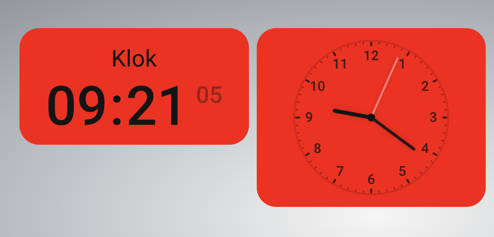

I still have a question : where the style has to be put in the theme file ?
In car-mod-card:
card-mod-card: |
  :host(.class-clock) ha-card {
    background-color: red !important;
    border-radius: 20px !important;
or in car-mod-card-yaml:
card-mod-card-yaml: |
Rgds.
card-mod-card when only one style.
card-mod-card-yaml when you have multiple yaml selectors for card-mod. In this example, with only self yaml selector, card-mod-card-yaml is not required.
Thanks for the answer.
Rgds.
btw, I should have been a more to the point…
the syntax used in those classes can be both ways:
        :host(.type-clock) ha-card {
the made up manual (.class-clock) modification is one you can used on selected entities of your choice. By using the method I showed earlier:
card_mod:
  class: class-clock
the (.type-clock) is automatically applied to all type clock cards you might have, and doesnt require setting a card_mod on the card at all.
so both have their strengths.
Manual selection and be specific
Auto application and be generic
it is up to you and your needs
this is the generic mod … :wink:
also applies to the type:clock in the header
Perhaps it is inherited.
And this way? What is displayed there?
And then hover and jump to the defintion.

I stil have a problem using theme, maybe due to the fact that the clock card is encasulated in a streamline-card.
I make some tests today.
Rgds

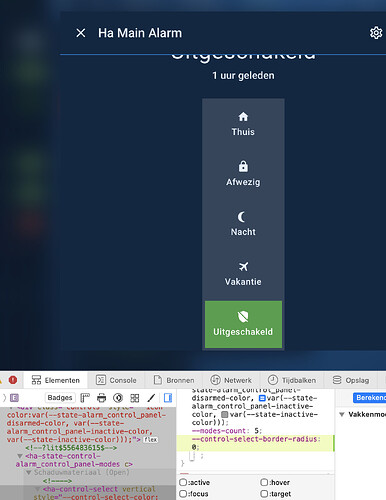

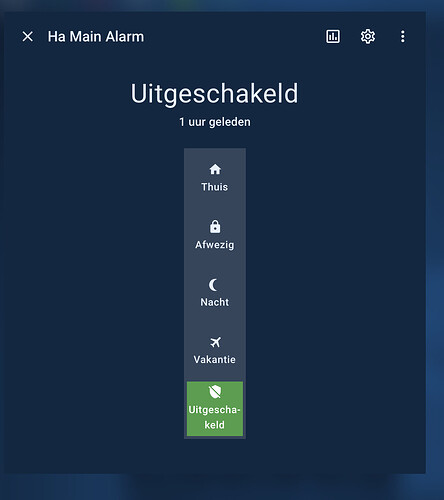

adding the border radius in Inspector works,
as does this in the theme mods:
    ha-more-info-info $ more-info-content $:
      more-info-alarm_control_panel $:
        ha-state-control-alarm_control_panel-modes $: |
          ha-control-select {
            --control-select-border-radius: 0 !important;
edited from a typo…
add the thickness:
          ha-control-select {
            --control-select-thickness: 85px !important;

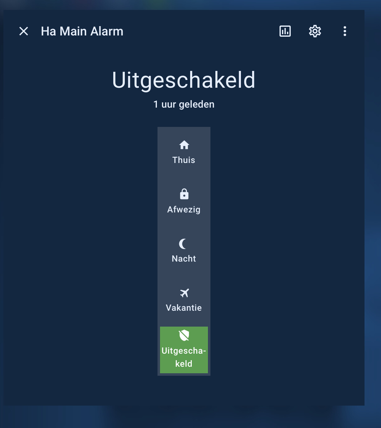

finally, use the same thickness on all squared more-infos, and the HA Frontend built-in border-radius-square
          ha-control-select {
            --control-select-border-radius: var(--border-radius-square) !important;
            --control-select-thickness: var(--more-info-control-thickness) !important;
edit
just was confronted with the reason I didnt use border-radius-square once again…
it’s not supported on all Frontend stock vars… which is plain silly of course.
    ha-card-border-radius: 0px #var(--border-radius-square)
    ha-dialog-border-radius: 0px #var(--border-radius-square)
    ha-card-features-border-radius: 0px #var(--border-radius-square)
    ha-button-border-radius: 0px #var(--border-radius-square)
    popup-border-radius: 0px #var(--border-radius-square)
all cant be set with it (and now I leave that commented in my theme so I dont forget)
reason: border-radius-square is set to 0, and not 0px
I did chat about that with the Frontend devs when that var was introduced, but they simply take the pov that 0 is default in CSS and 0px would be incorrect.
Their own Frontend proves differently however.
