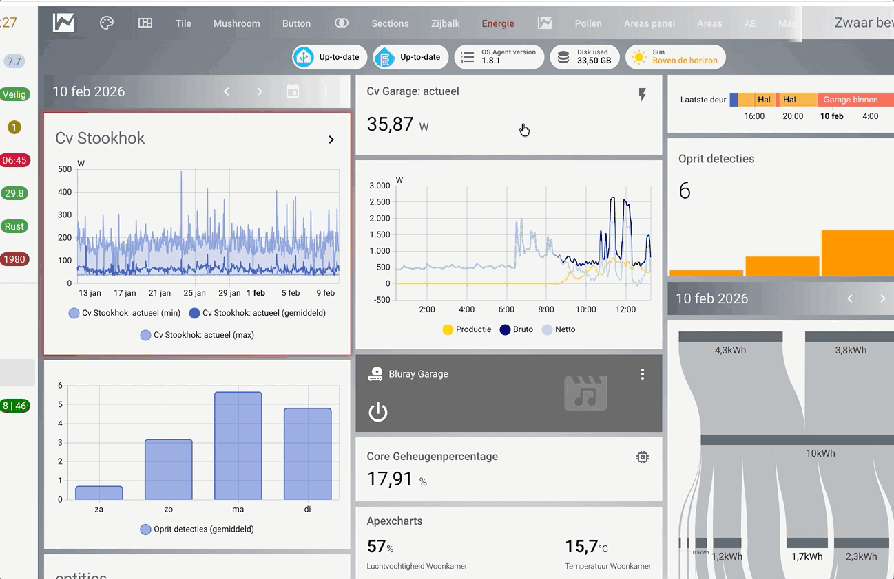

somehow the backdrop filter is behaving erratically recently, suspect it was introduced in the new HA 2026.x release, but not sure
Could anyone here using Safari on a Mac confirm?
  card-mod-more-info-yaml: |
      .mdc-dialog {
        backdrop-filter: blur(17px) !important;
        -webkit-backdrop-filter: blur(17px) !important;
It seems to not happen in Chrome, and its a bit hard to see in the sceenvid (real view is way more expressive), but there’s a certain kaleidoscopic effect on the elements, where before, a calm and clean blur was rendered only
Feb-10-2026 13-31-01
