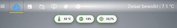

wait there’s progress!
using the above (including the setting for FF which is also required for Companion app) I can see the badges in 1 line, and swipe them if so needed.
changing the justify-content to center helps. Although admittedly, iit is a compromise… the badges are nicely centered now on all views that have but a few badges. But, on the views that matter, ie the ones that require swiping, entering the badges makes the first badge be displayed cut -off
all in all its a nice feature.
1 issue I still see, is there is a certain background discrepancy I need to screenshot to be understood
need to check how to set a single background for the complete view, and not differentiate between the sections section and the badges section…
dont think it is the box-shadow I set in all badges, as you can see the clear demarcation between the 2 sections in the view

commenting the theme makes it happen. This is the smallest window I can make on desktop, and notice the large gaps left and right side:
Feb-04-2025 14-55-38
update
gaps left/right are in Safari Mac Desktop only. Companion app and Chrome Desktop are fine. Meaning I can not adjust the margins in a theme, or kill Companion and Chrome views…
you could try
justify-content: space-evenly !important;
which does a few nice things:
  • does not cut off the left-side (of course it does on the right side , in the swipe direction)
  • shows symmetrical badges on views with less than view width badge numbers
  • spreads the badges over the full width, if but a few :wink:
and most importantly, show a single badge dead center:
kind of neat really

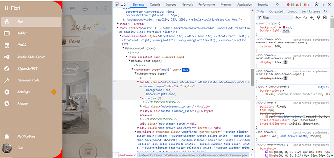

Hello to all, I have tried reading all the documentation regarding this card_mod theme I could find but I have not been sucessful and what is worst I can not find the explanation of why.
In case there is anyone who can and is willing to help me I“m trying to do this:
Where I want to put the red background transparent and delete the border to make it seem like a rounded menu.
I have done this on the theme code:

  card-mod-theme: Flor #change with theme name
  card-mod-more-info-yaml:
      ha-dialog {
        --vertical-align-dialog: center !important;
  card-mod-sidebar-yaml: &card-mod-sidebar |
      :host {
        border-top-right-radius: 50px !important;
        border-bottom-right-radius: 50px !important;
        box-shadow: rgba(0, 0, 0, 0) 50px 0px 0px 0px;
      .menu ha-icon-button {
        color: red !important;
        --mdc-icon-size: 10px;
      .menu .title {
        color: cyan;
    home-assistant-main$:
      ha-drawer$: |
        aside {
          border-top-right-radius: 50px;
          border-bottom-right-radius: 50px;
I also have a sidebar-config.yaml but any change there brokes this card mod. My main problem is that I can“t find the correct selector as you can see. I have tried modifying it accordingly to previous comments but I can“t seem to reach it.
Just in case anyone is able to help me, thanks in advance!
Been trying to figure this out too, same situation for me only the top part gets rounded but the background doesn’t and I tried multiple different selectors…
